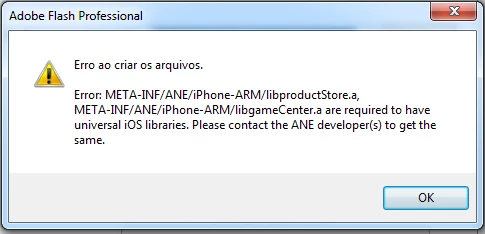

NEEDING HELP URGENT WITH ADOBE GAMECENTER 64 bit ANE
Please guys, i'm needing ao much help with this ane... I'm using adobe flash CS6 with the last update. My problem is when i try to build ipa with gamecenter 64bit ane and productstore 64 bit ane delivered from adobe. I always get libgamecenter.a and libproductstore.a are required... But insine ane/meta-.../ there is a libxx.a file... I tried to do all and nothing works and i realized that if I create a new file, and try to use this anes i get another error in CS6 telling that temp files are not found as ABC (something like this).

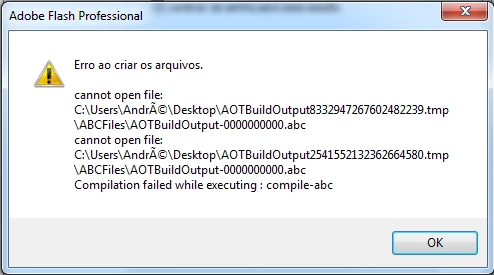

Don´t matter what sample code i use, even if i don´t use any sample code, just try to save and build ipa using or not using any ANE i get compile-abc error. But in my game that was saved before, i just get libxxx.a error.
I´m desperate, because my game is stopped and i can´t build. I have finished my game to android but to ios i can´t.
I have already tried to uninstall and reinstall the Adobe Flash CS6, and tried to Install Adobe Flash CC but nothing happens. I always get the same error
try to move your project to C:\myapp\

Apr 13, 2015 6:47 PM UTC
Thanks to Anton Azarov found out how to fix it. Some data from old ane gets stuck in temp so:
1. Use ane from here Gaming SDK ANEs - Universal 64-bit support | Adobe Developer Connection
2. Close flash cc  and clean temp folder in windows.
2.1 if it does not work clean this one as well C:\Users\<USERNAME>\AppData\Local\Adobe\Flash CC 2014\en_US\Configuration\CodeModel and temp as well.

Apr 13, 2015 1:37 PM UTC
Looks like Java can't read folder with name Anrdé from screenshots above. Most best and easy solution - it's rename your user from Anrdé to Anrda
Apr 13, 2015 12:55 PM UTC
Same issue here if I try to use adobe gamecenter ane it throws error libgamecenter.a and libproductstore.a are required.
I Tried newest gaming sdk and Gaming SDK ANEs - Universal 64-bit support | Adobe Developer Connection
They seem to be different at least if you look in META-INF/ane/extension.xml but none of them work...
