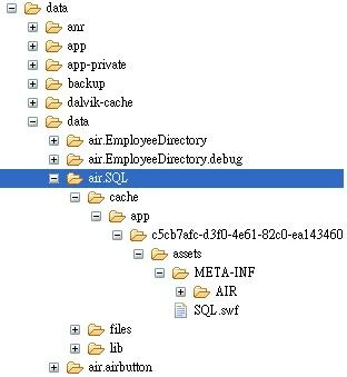

the image below I check my device data  that can't find sqlite file  inside.but I'm sure I pack sqlite file when publish apk.

First, never use the nativePath property of File.applicationDirectory (as the example does). This isn't supported on Android. You get an empty string. While you could usually bypass the write-restrictions on te application directory using this technique on the desktop, it definitely does not work on Android. Always use URLs rether than native paths to refer to application files.
What you should do is create the database in the applicationStorage directory. You could do this with SQL, or by coping a "template" database file that you packaged with the application from the application directory o the application storage directory (using the URL not the native path, of course.)

Thank you so much.My probelm has solved.
