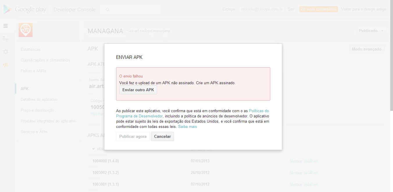

signing problems on new android developer console
Hi, I'm facing a problem while submitting apps created with AIR 3.7 to the google play. The apps are being self-signed as provided by AIR, using the certificate creation and packaging functionality provided by adt. However, when I try to upload them to google play I receive an error message about the lack of signing.
The strangest thing is that this only happens if I use the new developer console interface (the default one now). If I go back to the old interface, the upload process is completed and the app is published as it was on the past. Had anyone face this? Is this a known bug of AIR packaging or of the new google play publish interface?

Hi, Nimit, the problem persists even with the latest version of the SDK. It's a quite strange problem, indeed. The app I sent to Google play using the old interface - and accepted - became available and installs with no problems on Android devices - new installations or updates from previous versions. I contacted Google about it without success... Here is a screenshot of the problem on the new developer interface:

The certificate was created with the following command line on Windows:
adt.bat -certificate -validityPeriod 25 -cn Managana 1024-RSA Managana.p12 [my password here]
This very same certificate file was used on all previous versions of the sofware, and I never got any problems using it...

I tried with the certificate command you had mentioned, also with the certificate created by flash builder 4.6  but I am not able to reproduce the issue. Could you please open a new bug at bugbase.adobe.com, please include all information needed like OS version, SDK version, steps involved to create a certificate etc. Once added, please post back with the bug URL so that others affected can add their comments and votes.
