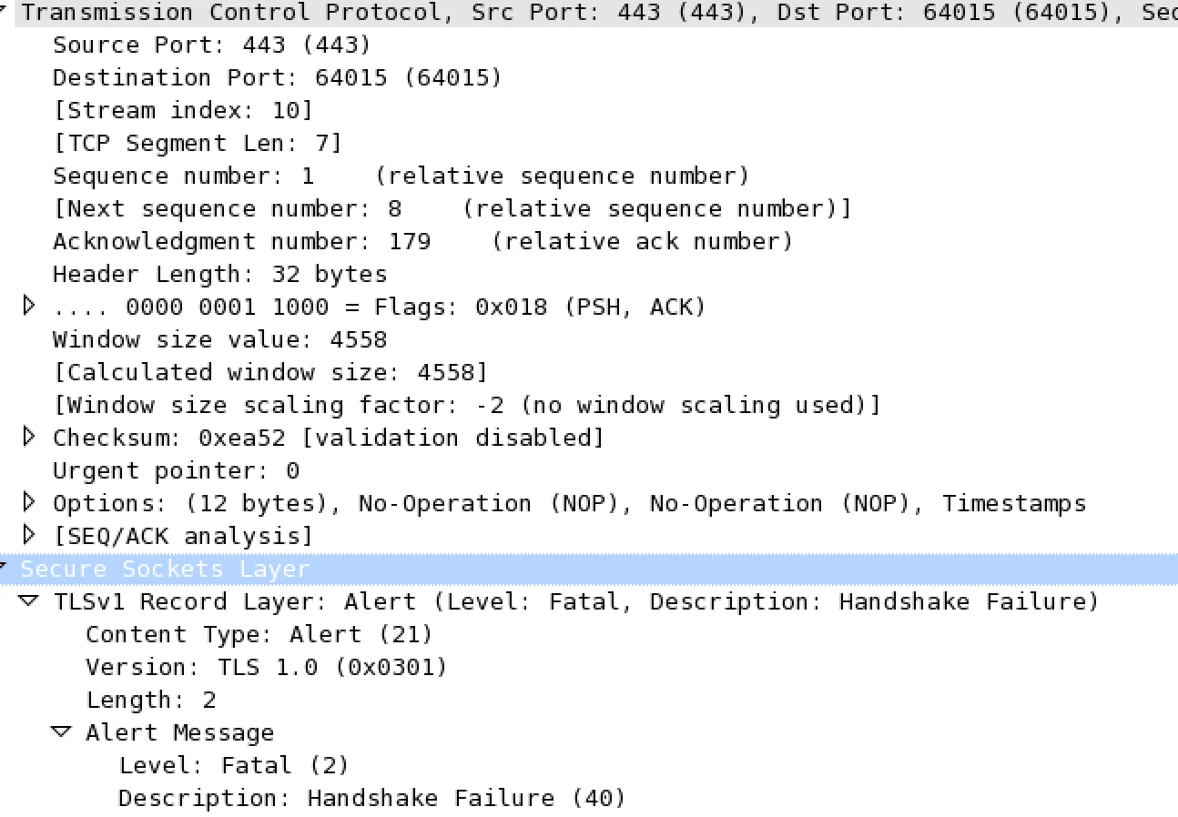

I wrote below code to test that url. SecureSocket connection is successful. but UrlRequest is failing, because it is using TLS 1.0 version to connect to server., Since Air app uses TLS 1.0 protocol, the handshake itself is failing. I found that info in wireshark:  TLSv1 Record Layer: Alert (Level: Fatal, Description: Handshake Failure)

@kumarkasimala - What version of AIR are you using in your project?  If you can, could you verify the behavior with AIR 19.0.0.241?
Chris
@kumarkasimala
Our QA team has been able to reproduce this issue.  We're considering this a bug and will start work on fixing it for an upcoming release.  Our internal bug number for this is 4095988 in case you need to reference it later.
Chris

I'll ask the team, but I believe AIR on Windows uses the network stack provided by Microsoft/IE.  Are you able to hit the same site using IE with TLS 1.2?
Nov 16, 2015 10:26 PM UTC
chris.campbell‌ Thanks for reply. Yes. After enabling TLS 1.1/1.2 from Internet options in IE, Adope air  Desktop client is connecting without any issues in windows because  air/flex sdk uses IE libraries to make ssl/tls calls.
But It is not working in MAC. It looks like it uses openssl client to make ssl/tls calls. Not sure what is happening with openssl.
It would be great helpful if you're team help with me any docs or info or solution..
