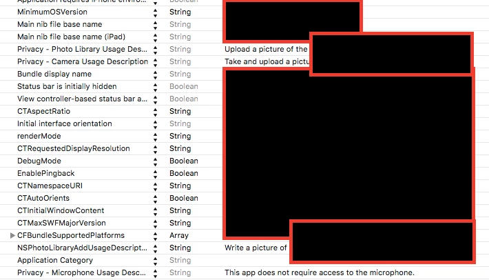

I have the same problem in Adobe Animate building IOS app in test mode. SKD 28.0.0.125
While updating an older application. Camera permissions dialog does not pop up. Additionally in settings on the iPhone under my app, there are no options to enable Camera Use. What could be the problem? I added the NSCameraUsageDescription and others to the xml file, please see below.
I attempted severa times, I deleted the app and recompiled it and installed via USB. Allow camera pop-up does not show. Checking the code in the debugger I get: PermissionError: 'Error #3800: This call requires CameraUI permission. in this line cCameraUI.launch(MediaType.IMAGE); after passes camera support test.

Mar 11, 2018 5:00 AM UTC
Just a thought it could be related to NSPhotoLibraryAddUsageDescription.
If I open the plist in Xcode I don't see the private in front of it. Notice in the image it does not say Privacy -
