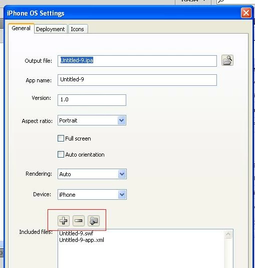

What you'r using flvcomponent? or StageWebView to load video with the ipad native player? below is the screenshot to attach the video while packaging your ios:

If it works when you do a Test Movie, but not on the iPad, the most likely thing is that you didn't add the video files in the iOS settings, in the lower half of the General tab.
