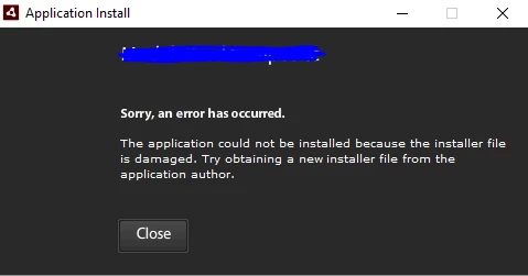

Windows 10 not supported? "The application could not be installed"
Hi, I have Adobe AIR 20 in stalled on my windows 10 and after building my AIR project i get this message. There is nothing wrong with the build and the file is NOT damaged,  i have tested the same file on Windows 7, 8,8.1 and Mac, it works.  Is there something else i can try or de we need to wait for Adobe to fix the problem?
Also I do have full admin rights and my user account control settings are set to the lowest possible selection.

I found that if package it as an .exe instead of .air it will install on W10.

I had the same problem. All my install files were corrupted.
I tried the alexandre's way but without success.
Then I tried another way : after switching off the antivirus (Bitdefender in my case) I'd re-downloaded the install files (Roland Vdrums Friend Jam app in my case). Then I tried to re-install and then!!!! IT WORKS!! Thanks alexandre_lac for your contribution!

Hi, I had exactly the same problem yesterday : Windows 10 freshly installed, same .air worked on other PCs (Windows 7, 8.1 and 10) and MACs.
I finally find out that my antivirus (Panda) blocked the installation without notifying this to me.
Watching logs, I assume that temporary decompression is refused to the AIR installer, so it considers the .air file as corrupted.
Try to switch your antivirus off for the installation time.
