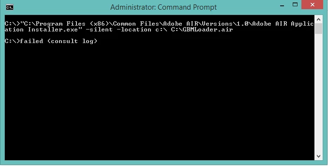

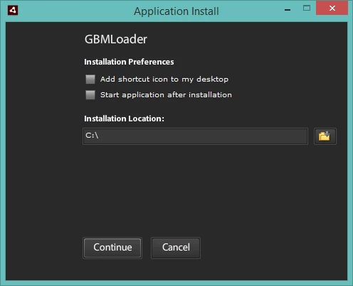

This works fine except the default installation location of the AIR application is wrong. The application should point to the C root. I tried the "location" switch but I get "too many arguments" or failed as feedback.
"C:\Program Files (x86)\Common Files\Adobe AIR\Versions\1.0\Adobe AIR Application Installer.exe" -silent -location "C:\" "C:\GBMLoader.air"
Anyone any idea what the correct switches are?

Check the 'C:\Users\[Username]\AppData\Local\Adobe\AIR\logs\Install.log' for the specific reason for the failure.
