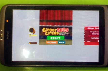

I'm developing a game with AIR 2.7 and have encountered a very rare and very bizarre issue where if the game is loading while my phone's screen is off (HTC Desire) landscape/GPU fullscreen can break and the game is displayed at 50% of fullscreen scale even though all Stage properties indicate the stage is the correct size.
It's possible to recreate an instance of this issue by using the 'Debug Movie on Device via USB' with the phone's screen off and only unlocking it as the game is loading at the point the "[SWF] android_app.swf - 5863962 bytes after decompression" line has appeared in the Output panel.
Photo of my phone showing this problem attached:
By allowing Auto-orientation in publish settings I found that if this issue had occurred rotating the device instantly corrected it and fullscreen worked.  That lead me to find that toggling stage.displayState between "normal" and "fullscreen" also cleared this issue.

The fix for the fullScreen issue was specific to iOS. If you are seeing this problem on Android, I encourage you to file a bug at http://bugbase.adobe.com with all the relevant test files.
Sanika
Jul 20, 2011 2:36 AM UTC
yeah... fixed on iOS, confirmed it is not fixed on android.
thanks
