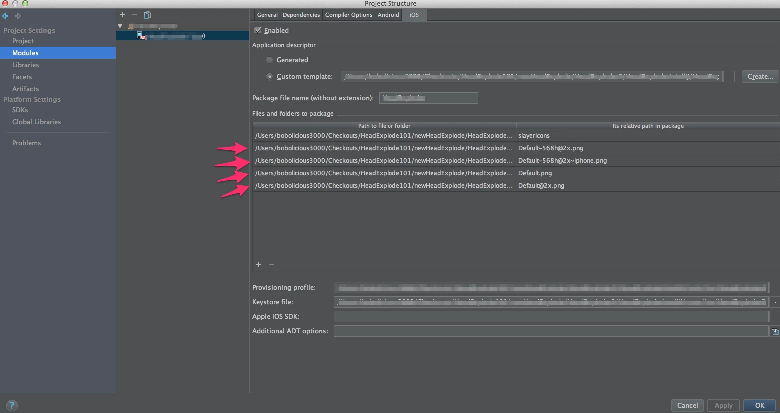

This is very frustrating. I have created an ios app, and I am trying to publish to ios app store with application loader. The problem is that I keep getting this error:
I have tried to look this up of course, but the answers form others don't help me at all. I am using AIR 4.14 and publishing from Intellij Idea.
In both my root project folder and src folder I have these two images files, size 640x1136: Default-568@2x.png and Default-568h@2x~iphone.png
I have tried a ton of variations and different image names, but I am completely lost now. Does anyone know how to fix this?
Thanks.
huhuhuh77Correct answer

It seems that my mistake was not with the AIR version, but with Intellij IDE. It is not enough to simply have the images in the root folder of src folder. You also have to specify them in the "Files and folders to package" area on the IOS tab for the module you are working with (in the Project Structure window).
The application loader accepted my ipa, and it's all good now.

If you unzip the IPA file and look inside the .app file, do you see the Default-568h@2x.png there? I don't know Flash Builder or Eclipse enough to know how you embed images, but the error message is suggesting that the image isn't there.
huhuhuh77Author
Dec 2, 2015 9:13 PM UTC
Hi.
When I rename the ipa file to .zip and open it I do see both Default-568@2x.png and Default-568h@2x~iphone.png in the rot folder.
I don't see a src folder in the unipped ipa. Should I? I do see everything else in the project.
huhuhuh77Author
Dec 2, 2015 9:16 PM UTC
I'm also not mentioning these images at all in the descriptor xml. I believe there is nothing to put in the xml for those startup images so please correct me if I'm wrong on that.
