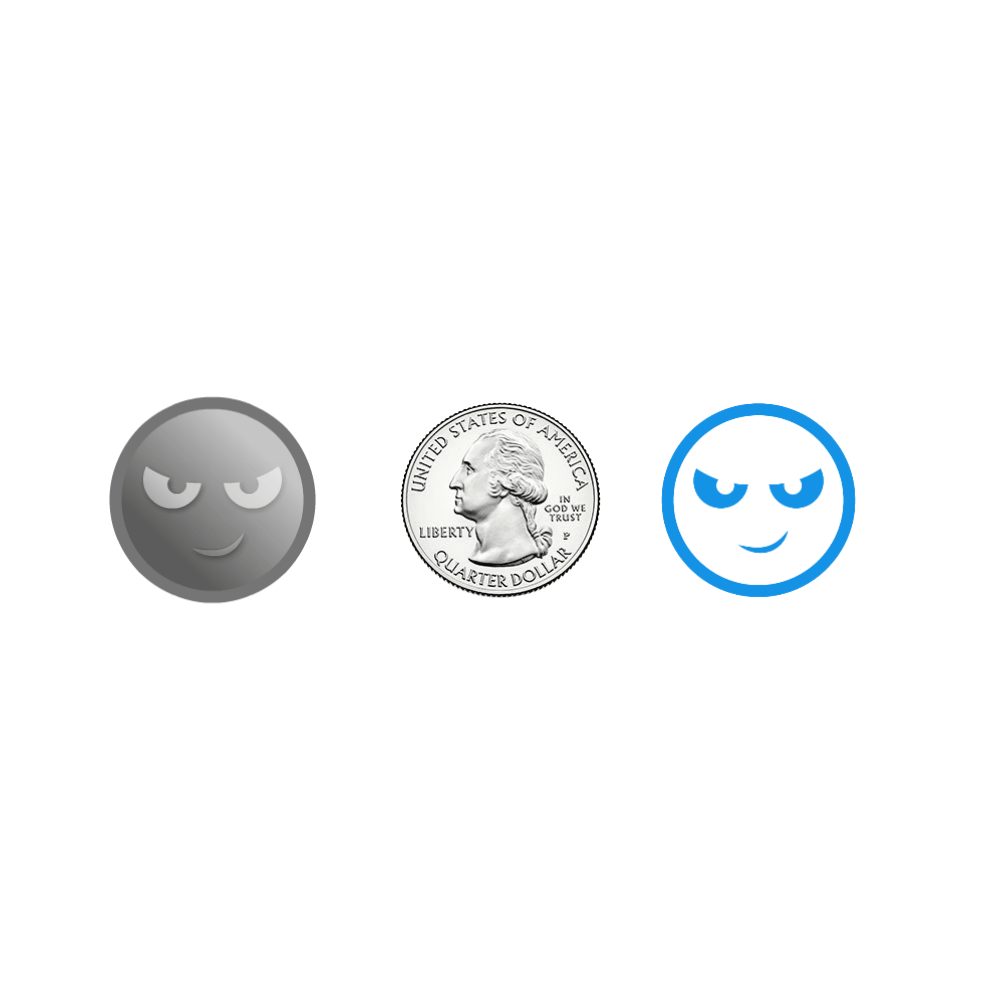

3d Rotate Tool rotating off center
When I used the 3d rotate tool in a motion tween on a coin png it looks pretty good but when i use it on a circle shaped vector graphic it spins off center.  Anyone else ever have this issue?  Sometimes the x or y 3d rotate looks a bit whobbly.  (See attached)
Any advice would be appreciated.
Thanks.

GrafixJoker
March 21, 2021
Thanks.  Yes I understand how to setup the 3d rotate and checked that the circles have correct width and height but if you take a look at this you will see the quarter spins well, but the two faces do not spin on the centers perfectly and they turn oval at one point.  Is it just an optocal illusion?
kglad
March 21, 2021
i don't see a problem but i do notice my gif is tweening smoother than yours (which shows a sudden abrupt change when the reverse side is displayed) instead of the smooth transition shown by mine.
