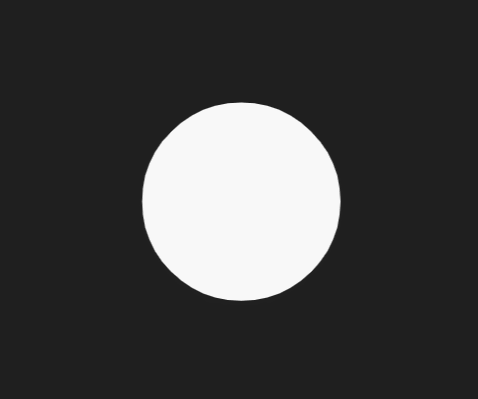

    I would like to suggest another approach using TweenJS.
    This method has at least two advantages:
    - You don't need to create two animations (in and out);
    - The animation will change direction from the current frame.
    Preview:
    Try it:
    https://bit.ly/3eXIkBN
    JavaScript / JS code:
    var root = this;
    root.main = function()
    	document.body.style.backgroundColor = lib.properties.color;
    	stage.enableMouseOver();
    	root.button.mouseChildren = false;
    	root.button.on("mouseover", function(e){ root.hoverTween(e.currentTarget, e.currentTarget.totalFrames -1) });
    	root.button.on("mouseout", function(e){ root.hoverTween(e.currentTarget, 0) });
    root.hoverTween = function(target, destination, ease)
    	var duration = (Math.abs(destination - target.currentFrame) / lib.properties.fps) * 1000;
    	target.frame = target.currentFrame;
    	createjs.Tween.get(target, { override: true }).to({ frame: destination }, duration, ease).on("change", function(e)
    		var target = e.currentTarget.target;
    		target.gotoAndStop(Math.round(target.frame));
    root.main();
    Download / FLA / source / files:
    https://github.com/joao-cesar/adobe/tree/master/animate%20cc/html5_canvas/hover_tween
    I hope this helps.
