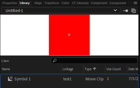

There's no need to instantiate a new stage because there's already a Stage instance called stage that is created in the publishing process.
To add a symbol from the Library, you have first to make sure it has a linkage name. Like this:
Then just instantiate it and add it to the display list:
var test1 = new lib.test1();
this.addChild(test1);
I hope it helps.
I hope it helps.

Thank you so much. I am embarrased to say that my library panel was docked and  so it didn't
look like your  screenshot until I expanded it. This is my  first post, what do I do to rate you or your answer. I have marked it as the correct answer. Is there anything elses i should do?
