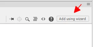

at the top right of the actions panel, do you see this:

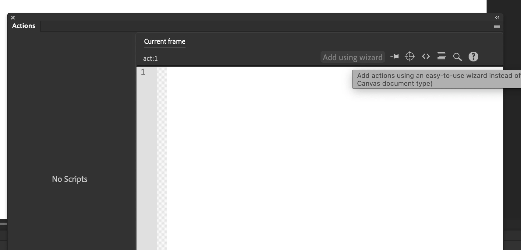

why am i unable to use add using wizard button in action script
Joseph Labrecque
May 26, 2021
It hasn't been made to work with ActionScript. That's all.

the code wizard is for html5 only, How to use ActionScript with Animate CC
October 18, 2018
correct, but the wizard doesn't appear when I am in html5.  There is no option to use the wizard.  I have created a button and tried to add action to it using the wizard, but the wizard option doesn't appear in the action window.  What am I missing?
Do I need to change a setting?
kglad
kgladCommunity ExpertCorrect answer
October 18, 2018
