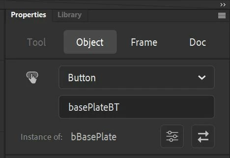

this.basePlateBT.addEventListener("click", MouseClickBasePlate.bind(this));
function MouseClickBasePlate() {

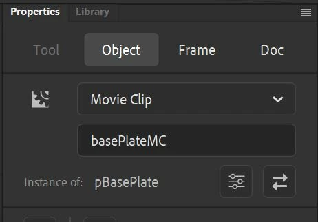

	this.basePlateMC.play();
basePlateBT is the name of the transparent rectangle
This should trigger the function called "MouseClickBasePlate". I copied and pasted it every single time in the code where I needed it.
The function should play a MovieClip called "basePlateMC"

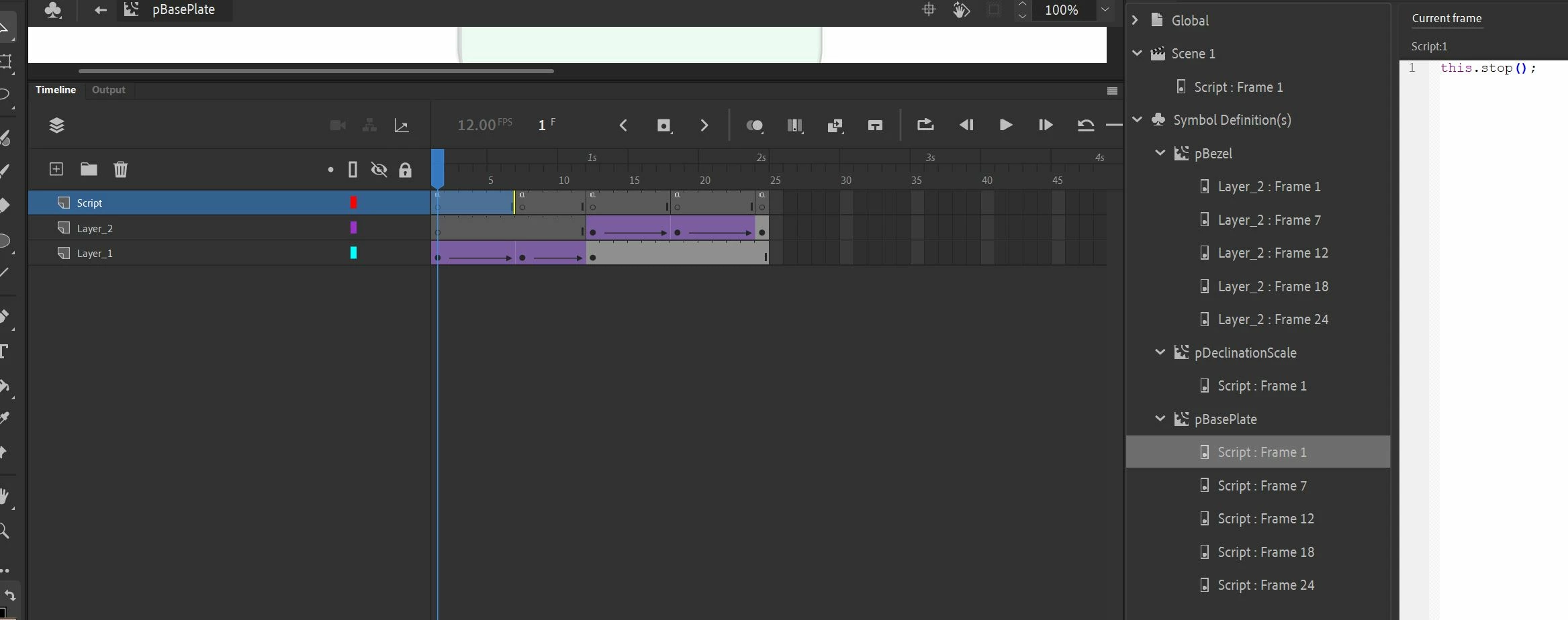

The MovieClip has several 'stops' because I need to roll out and also play other parts during other interactions, but nothing happens...

Because of the transparency of the button.... 1% solved the problem....
