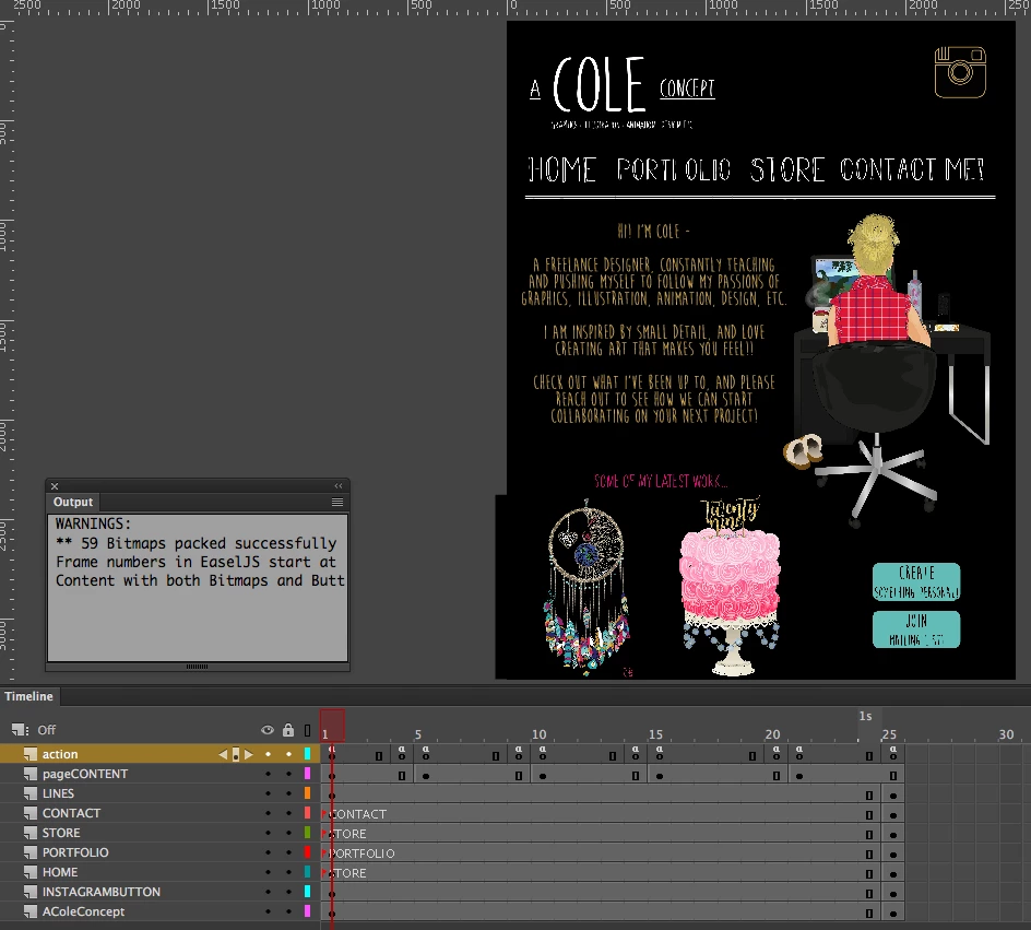

Hey there - I am looking for help.
I am new to Adobe Animate, but working on a project to create a Portfolio/Webpage.
I have created an HTML5 document, and have created a WORKING legend (with Code Snippets) that skips from one page to another.
On my Homepage (Frame 1) there are three images. I have added a code snipped to each so that they open a new web page (the same photo opens in a new window FROM MAILCHIMP, where I have housed the images.)
THESE IMAGES, AND BUTTON WORK NO PROBLEM!
My issue comes on FRAME 5. I have similarly set up multiple images and am trying, as I did in frame 1, to link them to their source file so they will open larger in a new window. I've used the SAME CODING AS ABOVE, but they will NOT OPEN when I test the file!!! I have the same issue with the BUTTON on the FIFTH FRAME!
I have been pulling my hair out for a week trying to figure out what my issue is, and I would SO GREATLY APPRECIATE ANY GUIDANCE!!!
HERE IS THE CODING (and screenshot) I HAVE USED FOR FRAME 1 - EVERYTHING WORKS NO PROBLEM!!:
this.HOME.addEventListener("click", fl_ClickToGoToAndStopAtFrame_27.bind(this));
function fl_ClickToGoToAndStopAtFrame_27()
this.gotoAndStop(1);
this.PORTFOLIO.addEventListener("click", fl_ClickToGoToAndStopAtFrame_28.bind(this));
function fl_ClickToGoToAndStopAtFrame_28()
this.gotoAndStop(5);
this.STORE.addEventListener("click", fl_ClickToGoToAndStopAtFrame_29.bind(this));
function fl_ClickToGoToAndStopAtFrame_29()
this.gotoAndStop(10);
this.CONTACT.addEventListener("click", fl_ClickToGoToAndStopAtFrame_30.bind(this));
function fl_ClickToGoToAndStopAtFrame_30()
this.gotoAndStop(15);
this.PERSONALIZE.addEventListener("click", fl_ClickToGoToAndStopAtFrame_31.bind(this));
function fl_ClickToGoToAndStopAtFrame_31()
this.gotoAndStop(20);
this.button_1.addEventListener("click", fl_ClickToGoToWebPage_2);
function fl_ClickToGoToWebPage_2() {
window.open("https://www.instagram.com/cole.illustration/", "_blank");
this.MAILINGLIST.addEventListener("click", fl_ClickToGoToWebPage_10);
function fl_ClickToGoToWebPage_10() {
window.open("https://mailchi.mp/e8cac7e81bc9/u0qfsfrans", "_blank");
this.DREAM.addEventListener("click", fl_ClickToGoToWebPage_25);
function fl_ClickToGoToWebPage_25() {
window.open("https://gallery.mailchimp.com/88199473229b60d9e90951af6/images/34bd355b-126b-4e81-87fa-fe2efd7f7ad9.jpg", "_blank");
this.CAKE.addEventListener("click", fl_ClickToGoToWebPage_26);
function fl_ClickToGoToWebPage_26() {
window.open("https://gallery.mailchimp.com/88199473229b60d9e90951af6/images/c46a3d5f-4e8b-4db9-afda-224b10f5403c.png", "_blank");
this.WORKING.addEventListener("click", fl_ClickToGoToWebPage_28);
function fl_ClickToGoToWebPage_28() {
window.open("https://gallery.mailchimp.com/88199473229b60d9e90951af6/images/49df4cba-3829-475b-b1eb-eda2b48145a6.png", "_blank");
HERE IS THE CODING (and screenshot) I HAVE USED FOR FRAME 5 - WHEN I TEST THE FILE, EVERYTHING APPEARS, BUT (aside from everything ABOVE THE LINE) DOES NOT PLAY!
this.SUNDAYMORNING.addEventListener("click", fl_ClickToGoToWebPage_36);
function fl_ClickToGoToWebPage_36() {
window.open("https://www.dropbox.com/s/zldzz4gr0wk82vp/sundaymorning.png?dl=0", "_blank");
this.LIPSTICK.addEventListener("click", fl_ClickToGoToWebPage_37);
function fl_ClickToGoToWebPage_37() {
window.open("https://www.dropbox.com/s/xn59ygszz1wagvv/lipstick.png?dl=0", "_blank");
this.GORD.addEventListener("click", fl_ClickToGoToWebPage_38);
function fl_ClickToGoToWebPage_38() {
window.open("https://www.dropbox.com/s/2rrnr8cqnfqepc7/gord.png?dl=0", "_blank");
this.NASHVILLE.addEventListener("click", fl_ClickToGoToWebPage_39);
function fl_ClickToGoToWebPage_39() {
window.open("https://www.dropbox.com/s/f0jhjm3gczia67l/nashville.png?dl=0", "_blank");
this.BEDROOM.addEventListener("click", fl_ClickToGoToWebPage_40);
function fl_ClickToGoToWebPage_40() {
window.open("https://www.dropbox.com/s/ygq1wkrm0s5xt3w/bedroom.jpg?dl=0", "_blank");
this.ABBEY.addEventListener("click", fl_ClickToGoToWebPage_41);
function fl_ClickToGoToWebPage_41() {
window.open("https://www.dropbox.com/s/bfssgesqpzua9xu/wallart.png?dl=0", "_blank");
CHRISTMAS.addEventListener(MouseEvent.CLICK, fl_ClickToGoToWebPage); function fl_ClickToGoToWebPage(event:MouseEvent):void { navigateToURL(new URLRequest("https://www.dropbox.com/s/933jjd5ldccuoq9/christmas.png?dl=0"), "_blank"); }
