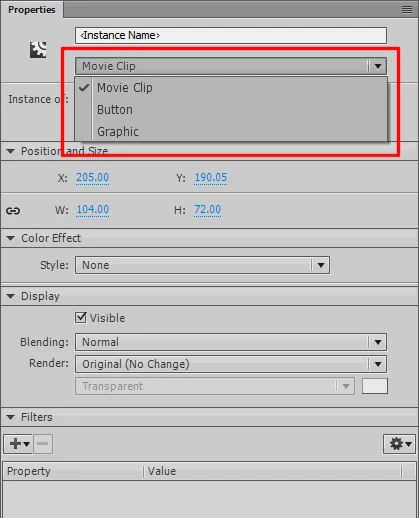

Hi mate,
Yeah, it can be confusing.
There are several types of symbols. What you have created is most likely a Movie Clip and you should be using Graphic.
Just select the instance on Stage and change its type from the Properties panel drop-down to Graphic.
Then you will get options to stop it and show only a specific frame, play once or loop.
In your case it should be set to 'play once' starting at 1.
How to organise the offset. Well... maybe at this stage it really is best to have each leaf on its own layer starting at a different frame. It will be very clear when you look at it and very easy to re-time. Put those many layers inside a timeline folder so that you can collapse them.
In animation we only use Graphic Symbols, unless there is a very good reason that you can name to use a Movie Clip.
Hope this helps!

Hi mate,
Hope this helps!

For anyone else struggling with this (if there is anyone), using the answer I was given above, I did the following:
My symbol (which I had improperly designated as a "Motion Graphic") can be found in the Libraries area. By right clicking the "file" I was able to click > Properties > and change it to Graphic in the drop down menu.
From there, I dragged my now Graphic back onto my stage, selected it using the selector tool, and in the Properties menu it finally showed me the drop down option to either "Loop" "Play Once" or "Single Frame"
Thanks y'all.
"Movie Clip". There's no such thing as a "Motion Graphic" in Animate.
Also, you didn't have to re-drag it onto the stage. All you had to do was change the existing symbol on the stage from Movie Clip to Graphic in its properties panel.
