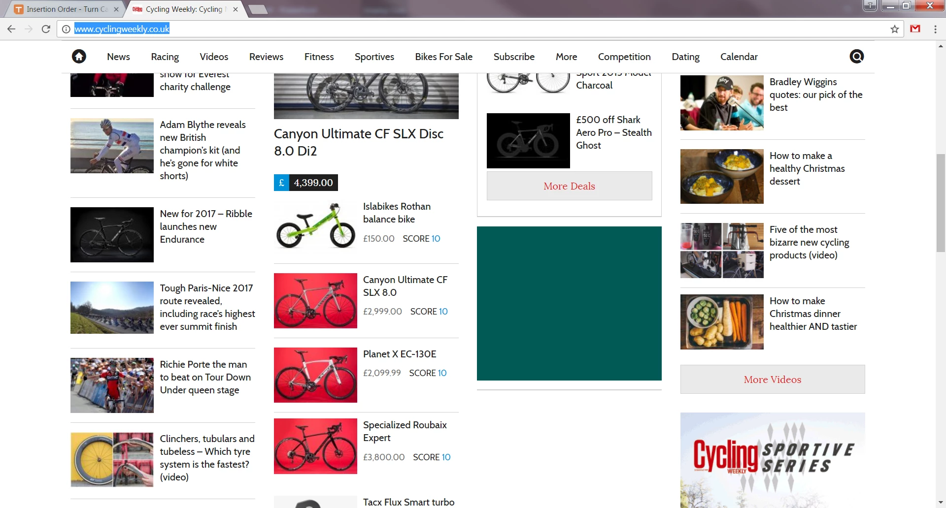

Hi there,
I'm working in online marketing and we're having an issue with our adverts not correctly loading into webpages occasionally. The issue looks like the below, it loads the green background but fails to load any of the animation or any other part.
We've previously noticed this happening on a number of sites, we contacted the company that serves our adverts Turn, they said that they thought the issue was due to the fact that multiple adverts were loading on the page and some were also done in Adobe Animate and both ours and theirs were using the auto generated tag "canvas" and so it was failing to load. We since manually replaced all our "canvas" tags with "canvas_evanscycles" but we've still found this issue occurring elsewhere. We then did some more research, found that other people have had similar issues as in the links below. However for all of these people they were the ones creating the webpage rather than just displaying an advert on somebody else's page. They also recommend changing the tag "lib" to something unique also which we haven't yet attempted.

So the first question I have is whether anyone knows of similar issues? If so does anyone know of any fixes other than what we have attempted?
The second part is that if the only fix is to manually change the "canvas" and "lib" tags then would every advert we serve need to have a unique tag? For example if we are serving an advert that is 160x600 and one that is 728x90 on the same page, if we change the 160x600 "canvas" to be "canvasABC" do we need to change the 728x90 "canvas" to be "canvas123"?

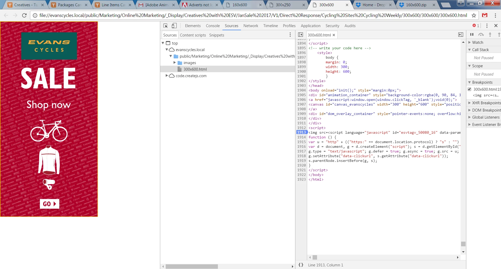

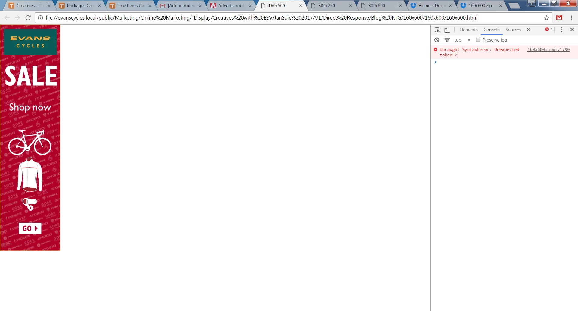

    This is the error I see in the HTML only page:
    When I click it, it takes me to this line:

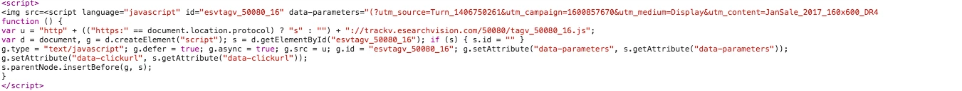

    Well the error is coming from this:
    There's no reason to have that <img src= there, and the script tag within the script tag doesn't look right either.  Do you need that stuff for esearchvision?  If so, you might want to check with them about how that tracking script needs to be set up, because it doesn't seem to be properly implemented.

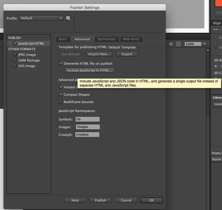

    Also, you've somehow managed to both publish your JS file and include the JS within the HTML, and you only need to do one or the other.  Right now your JS files are completely unused and just wasting extra file size.  Personally, I would republish the HTML without the JS embedded and keep separate JS files to keep things cleaner.  I don't think that has anything to do with your loading issue but it is something that would be best to fix.
    You can do that in Publish Settings.

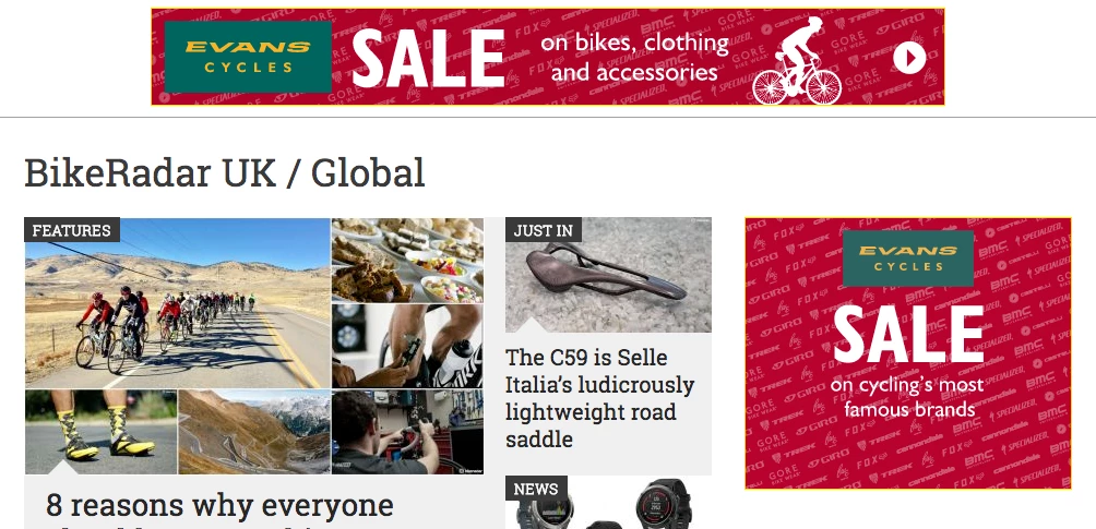

    Hey, I was finally able to get your ads to load on bikeradar.com, and they work fine on my end (on a Mac using Chrome).  Screenshot below.
    What browser/operating system are you experiencing issues in?

    January 3, 2017
    Hi Emma,

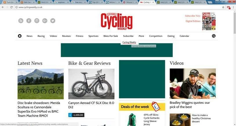

    Thanks for the response, I'm not using an adblocker and neither are the others who have seen this issue. We're using Google Chrome and here is a site that's had the issue: Cycling Weekly: Cycling News, Bike Reviews, Sportives & Forums You may need to refresh the site a few times to get served an ad from Evans.
    I've emptied my cache to test to see if that was the issue but it didn't resolve it either. Here is a screenshot I took just now after having emptied my cache and deleted browsing history
    Thanks for the help, it's very much appreciated.
    Tom.
    just.emma
    January 3, 2017
    I'm not seeing it no matter how many times I refresh; it might only be targeted to people in certain regions.
    Can you have the ad serving company set up a test page?
