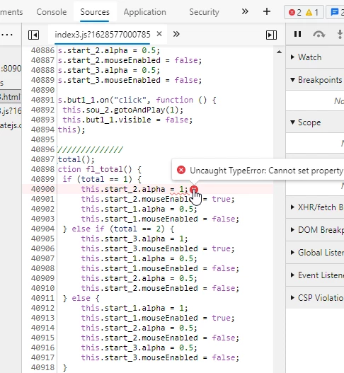

CodeDeveloperOM
Aug 10, 2021 6:30 AM UTC
Although it is simple and it is clear??
fl_total();
function fl_total() {
if (total == 1) {
this.start_2.alpha = 1;
this.start_2.mouseEnabled = true;
this.start_1.alpha = 0.5;
this.start_1.mouseEnabled = false;
} else if (total == 2) {
this.start_3.alpha = 1;
this.start_3.mouseEnabled = true;
this.start_2.alpha = 0.5;
this.start_2.mouseEnabled = false;
} else {
this.start_1.alpha = 1;
this.start_1.mouseEnabled = true;
this.start_3.alpha = 0.5;
this.start_3.mouseEnabled = false;
Even if you cancel this
Everything shows an error and does not execute
I don't know where is the problem?

Are you sure that you have an instance, available on that frame, with the exact instance name of "start_2"?

I use more than one frame
And in one of the frames (the final button  total++)
this.nextlevel.addEventListener("mousedown", fl_nextlevel2.bind(this));
function fl_nextlevel2() {
total++;
console.log(total);
createjs.Sound.stop();
this.gotoAndStop(0);
Go back to main until button 2 or 3 activates
