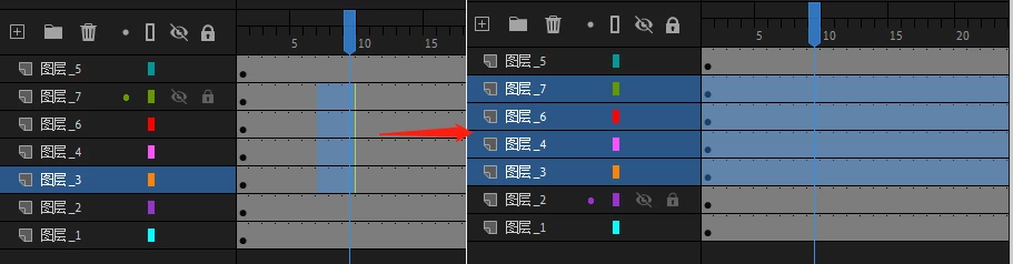

An error was thrown when selecting a layer using jsfl
Select a column of frames on the timeline, and then execute the command to select these layers, the following code will throw“Error: setSelectedLayers:Invalid parameter number 1”,
How can it be improved, and where is it wrong?
