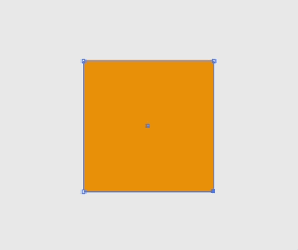

Illustrator:

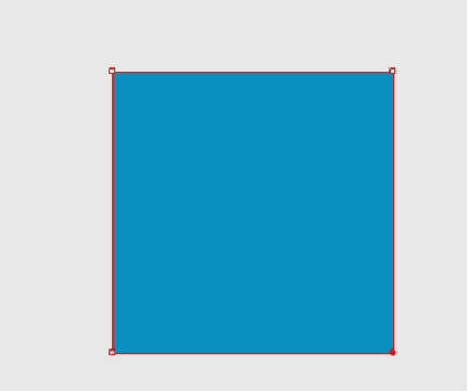

Animate:

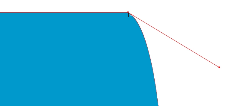

You can prevent the extra points somewhat by positioning one of the handles right on top of the anchor point like this:

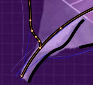

Oct 18, 2018 12:02 PM UTC
in this i just moved the end point and suddenly 3 more points appeared. Most commonly it happens when lines intersect but not always, and it can end up way more messy than this. also on a sort of unrelated note, is there a way to sub select lasso without cutting everything with the lasso? I'm an experienced illustrator user just switching to animate, and im loosing my mind with all the strange interaction differences. thanks!
