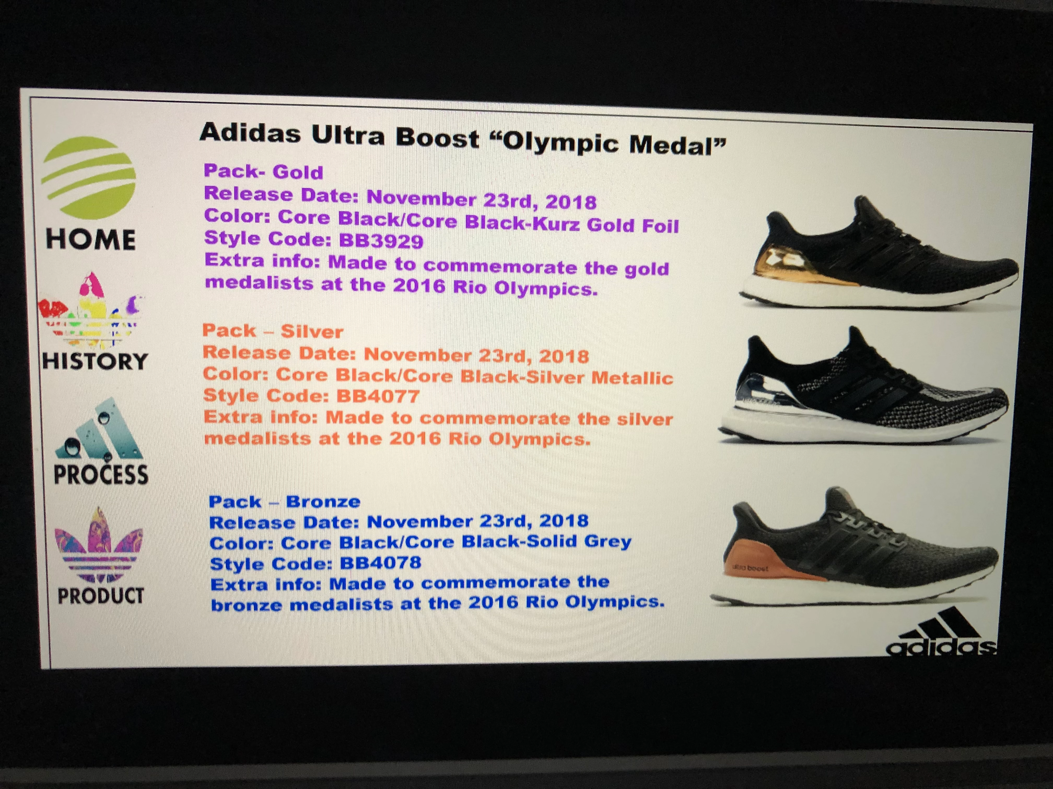

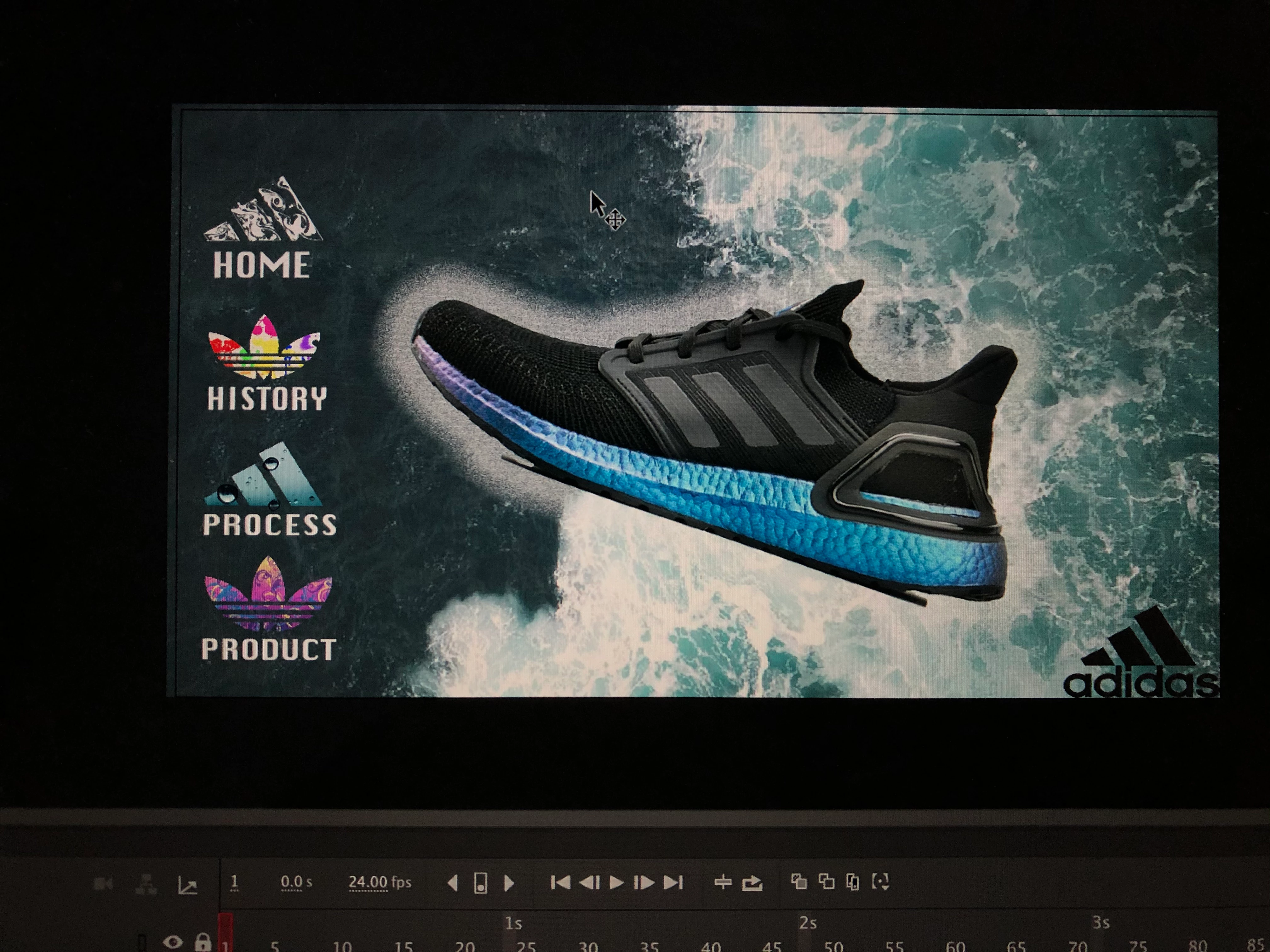

Hey guys! I have a question that I am struggling for some time that is the action script for "button on click" as picture below.

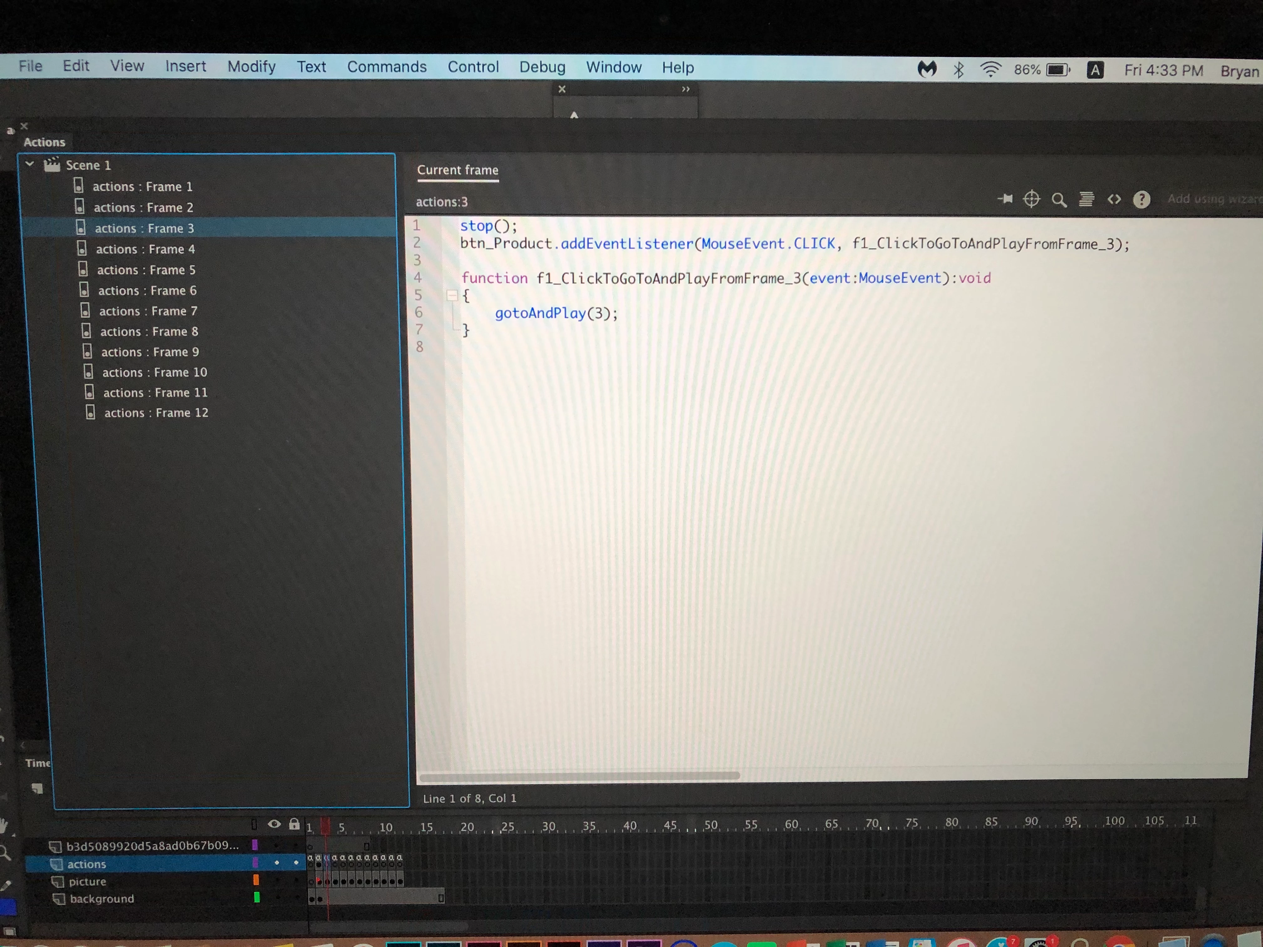

For my part: (look at 1st picture below) When I click "Product" button below, I want the "Product" information to pop out (2nd picture below). But I couldn't solve it with that. Maybe there's a problem on my action script/coding (3rd picture)
My problem is after I click the "product"button (1st picture) it didn't appear anything.

Hi.
I think it's like Lars said. You're on frame 3 of the main timeline and your code sends the playhead to the frame 3 of the main timeline. The result is that you stay in the same place.
Please confirm if this is the case or please add more infos so we can help you out.

To go to frame 3 you have to write gotoAndStop (3); not gotoAndPlay (3);
Dec 14, 2019 3:10 AM UTC
I tried already but is still the same...couldn't work...

Make sure the code for the btn and function is on the "start page frame", (probably frame number 1).
Dec 13, 2019 2:54 PM UTC
Yep, for the frame no 1 is okay but other frame, it couldn't "pop out" information. This is what I am struggling for...

Is the "pop out" information a single image directly on frame 3? Or is it an animation inside a MovieClip somewhere?
