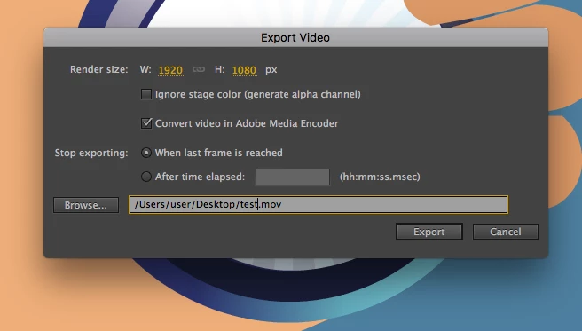

    to export in mov format you should choose export video ,
    then you choose the location and file type .mov and the frame size
    good luck

    Thank you for your response, but that's exactly what I'm doing, even up to the 'when last frame is reached'. It still won't export the whole thing.
