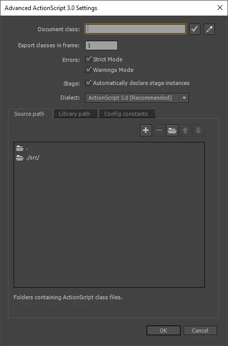

First, make sure you are typing the name of the class in the Properties panel without the .as extension.
And if your class is inside of any folder, you have to first include the parent folder of your class files in the source path settings (inside of the Advanced ActionScript 3.0 Settings window) and also set the correct package location in every class.
For example: if you have a folder called 'src' in the same folder as your FLA and inside this 'src' folder you have a folder called 'system' and inside of this 'system' folder you have another one called 'core', you would have to go to the source path settings and set the 'src' folder to be the container of your class files, like this:
And if inside the 'core' folder you have a class called 'Main.as', its basic structure would be like this:
package system.core
    import flash.display.MovieClip;
    public class Main extends MovieClip
        public function Main()
            trace("working");
And to make the 'Main.as" the document class, type in the Properties panel: system.core.Main.
