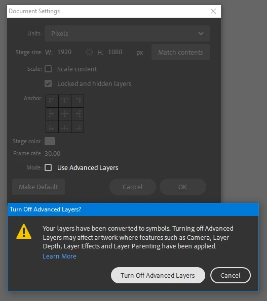

    Advanced layers are turned OFF via the Modify > Document... menu.
    You can make this default.
    By turning them off, you will lose Layer Parenting, Camera and filters for Graphic Symbols - all new features relying on this double wrapping.
    Incremental saves are done by using File > Save As... a few times a day and adding a suffix to your file name, such as _01, _02 and so on.
    You also must maintain at least two external backup copies of all your work to prevent data loss (nightly backups).
    One of these must be on a device that is not connected to anything apart from during data transfer (air gap).
