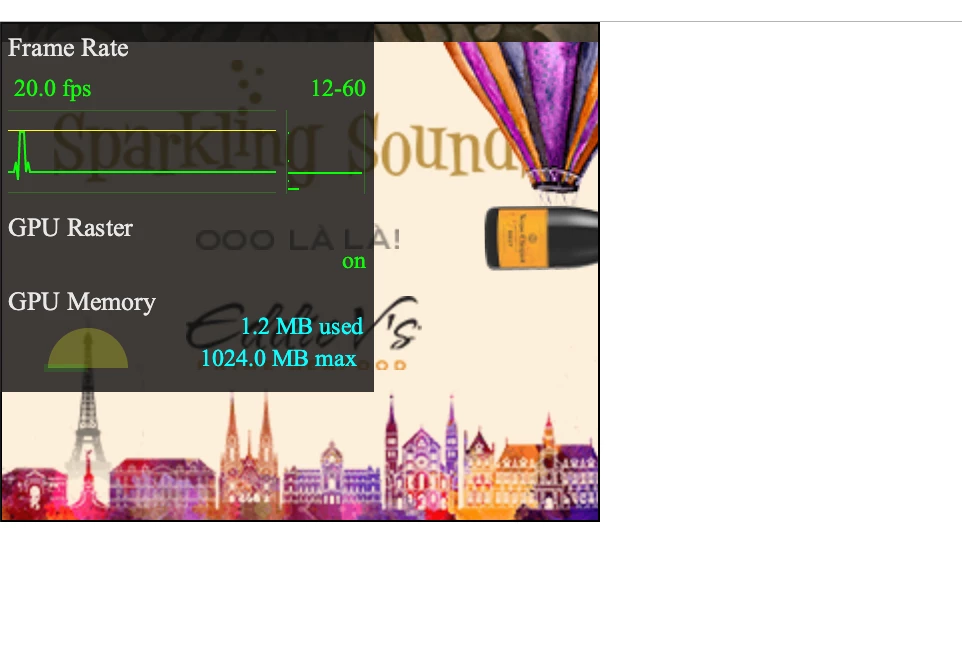

    I appreciate you attempting to help! I'm a developer and have already looked at the API and the actual code. I get the ticker and its methods and properties. That said, I DO have to worry about the frame rate because it's killing my animation. Not just this one, but all of them for a major client that is forcing us to use Animate because they have non-technical people who like it. Ordinarily I just hand code banners using GSAP and as you may know it doesn't explicitly set the frame rate, so the banners will run at the browser rate which is generally 60fps.
    Anyway, I've tested the Animate produced banners using Chrome's FPS meter and it's actually dumping down the rate to 20, which is predictable considering what I mentioned about multiples of 60 being optimal. If you set the rate to 30 in animate, it will play at 30.
    So, it seems to me that Animate is just throttling the banners for no practical reason.
    I would also add that this is a very simple tween that is jittery at 24fps. A 5k png (the balloon) going from x to x in 4 seconds.
    I don't know. I feel like I'm still missing something though.... What do you think now?
