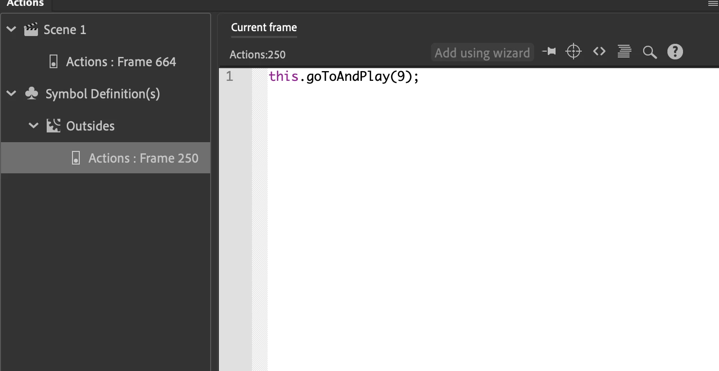

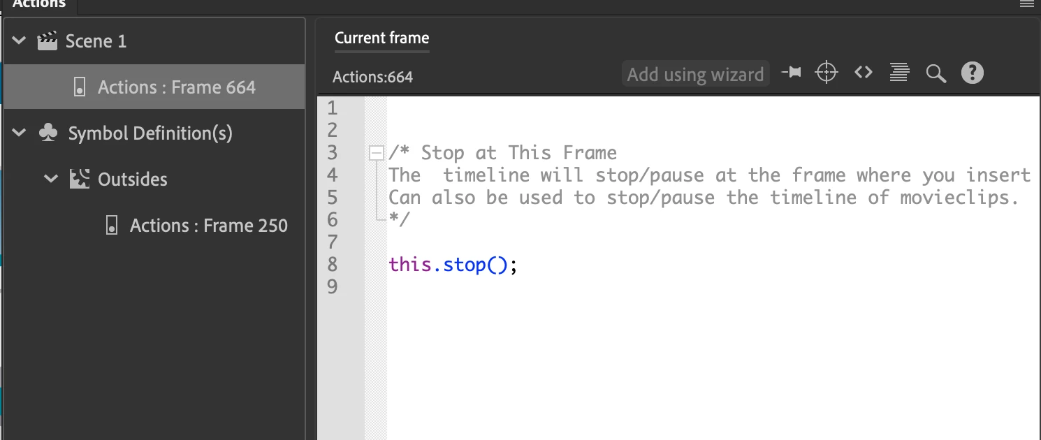

I have a group of frames with the action"this.goToAndPlay(9);" inside of a symbol. The symbol has the action "this.Stop();" and also has frames after it. When I test in the browser, the group of frames 'action' plays and the symbol frames 'action' plays also. The frames after the symbol action frames do not play though. Basically, the frames after an action of "this.Stop(); " is not playing. When I take off "this.Stop();" the frames play but the action "this.goToAndPlay(9); is not completing fully.

i'm not sure if you're using js or actionscript but both are case-sensitive and you have errors.
this.Stop() will fail, this.stop() will work.
this.goToAndPlay(9) will fail, this.gotoAndPlay(9) will work.
ie, fix your code and the text in your next message if that above fails to help you fix the problem.

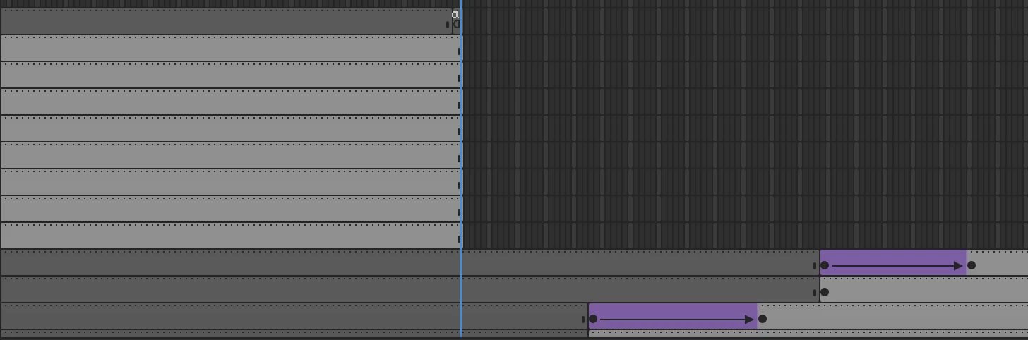

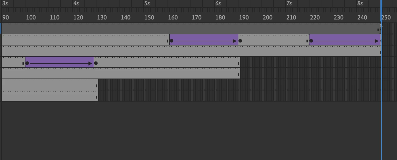

June 30, 2020
I didn't want it to loop. The problem was that the animation would play
then stop. After it stops, the next layer is supposed to appear but it
doesn't. It stays on the stopped animation.
