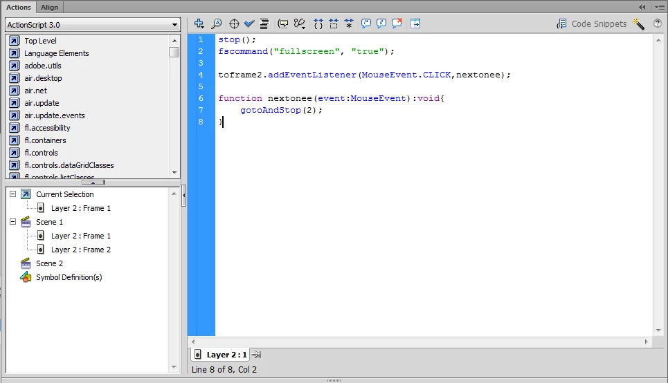

Hello, I have a problem on FLVPlayback, I am using actionscript 3, AdobeFlash CS6, flashplayer 11
in this case, I have two frames, namely:
on frame 1, I fill in the code:
stop ();
fscommand ("fullscreen", "true");
toframe2.addEventListener (MouseEvent.CLICK, nextonee);
nextonee function (event: MouseEvent): void {
gotoAndStop (2);

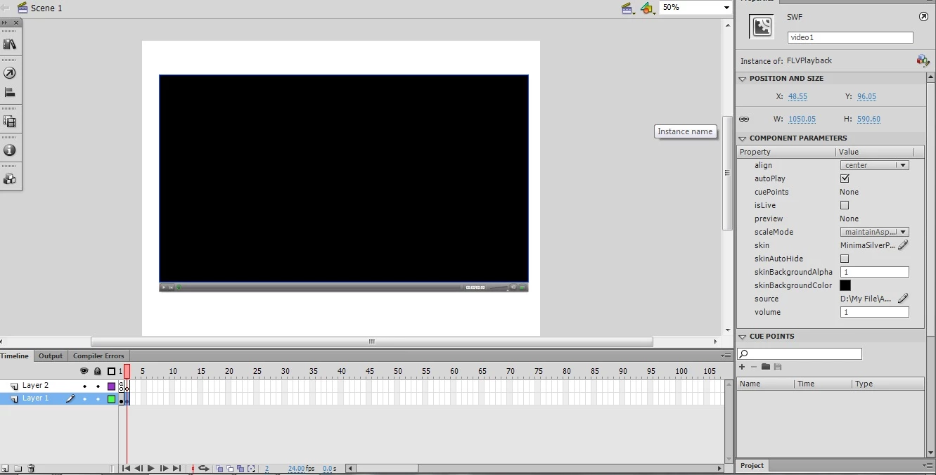

On  frame 2 is FLVPlayback with a resolution of 1280 x 720, and I resize it to 1050 x 590.60 because out of the stage.
When I publish and I run the SWF file its result is in frame 1 success and be fullscreen mode, and when I click the button to get to the frame 2,  I got was a black screen,
What is wrong? please help, thank you
This is the screenshot:
Correct answer kglad
fscommand I put on the frame 1. screenshot above is a frame 2
whether on a frame 2 also need to be added fscommand?
remove it everywhere from your file.

assign your component's fullscreentakeover property to be false and if that's a web-based project, you can't initiate fullscreen without user interaction (like a mouse click).

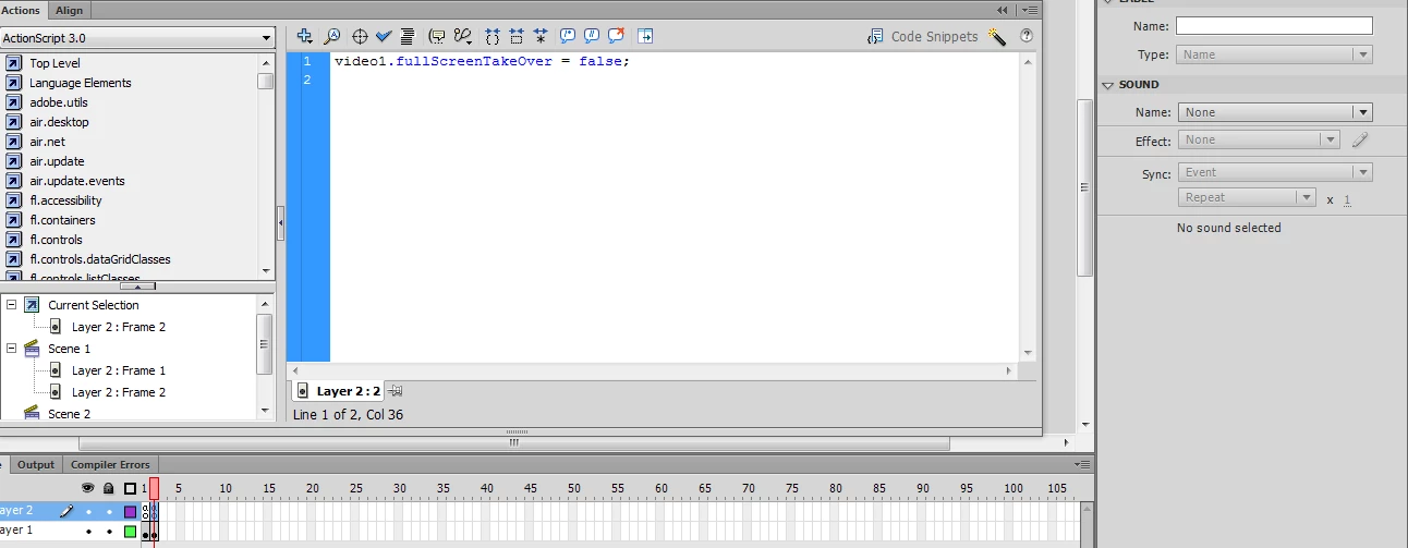

Hallo, kglad
This is not for web. if you mean like this? if so, the results remain the same problems that only show black screen. I wrote the code In frame 2:
video1.fullScreenTakeOver = false;
if the above code is correct?
kglad
February 3, 2016
and did you remove that fscommand?
