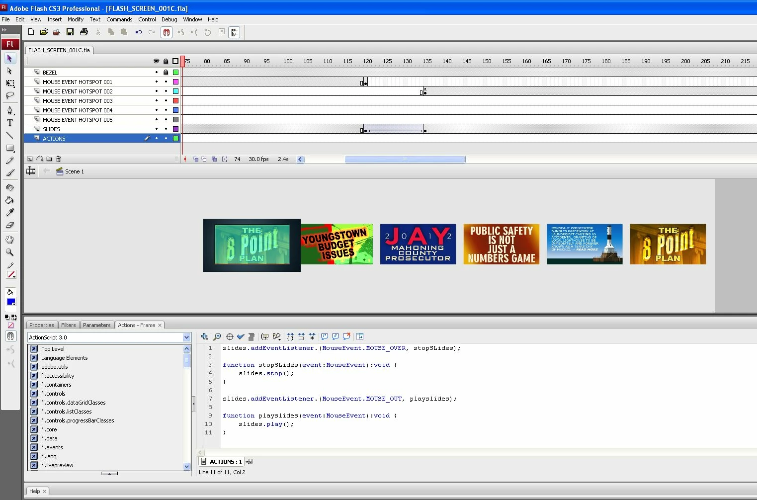

- This is my simple attempt of AS to pause the slideshow:
slides.addEventListener.(MouseEvent.MOUSE_OVER);{
slides.function = stop
slides.addEventListener.(MouseEvent.MOUSE_OUT);{
slides.function = play
Thank you so much for any help you can offer, I truly appreaciate it !!!

Thanks so much for your expert help!!!!   The code you provided was entered exactly but didnt work.
Above, those Still Image thumnails slide to the left, stopping at each slide for 5 seconds within the dark gray frame.... The entire strip of slides are animated with keyframes on the timeline.  I need a mouseover to pause this keyframed play, and then a mouse out to UnPause the slides and their sliding.....  When I entered your code - the slides didn't move at all, and yielded the following error message:
ERROR MESSAGE:
TypeError: Error #1123: Filter operator not supported on type builtin.as$0.MethodClosure.
at FLASH_SCREEN_001C_fla::MainTimeline/frame1()

As I said in my initial reply, if it doesn't work you'll need to explain the nature of the slides animation. What in your original code are you referring to as "slides".  If it is not a movieclip then it is not correct to be targeting it to play/stop.
Are all of the images you show on the main timeline?  If that is the case, then you just want to have stop() and play() in those functions, though you still need to explain what "slides" is.
As far as the error message goes, it  should not be related to the code provided since that code has no relationship to filters.
