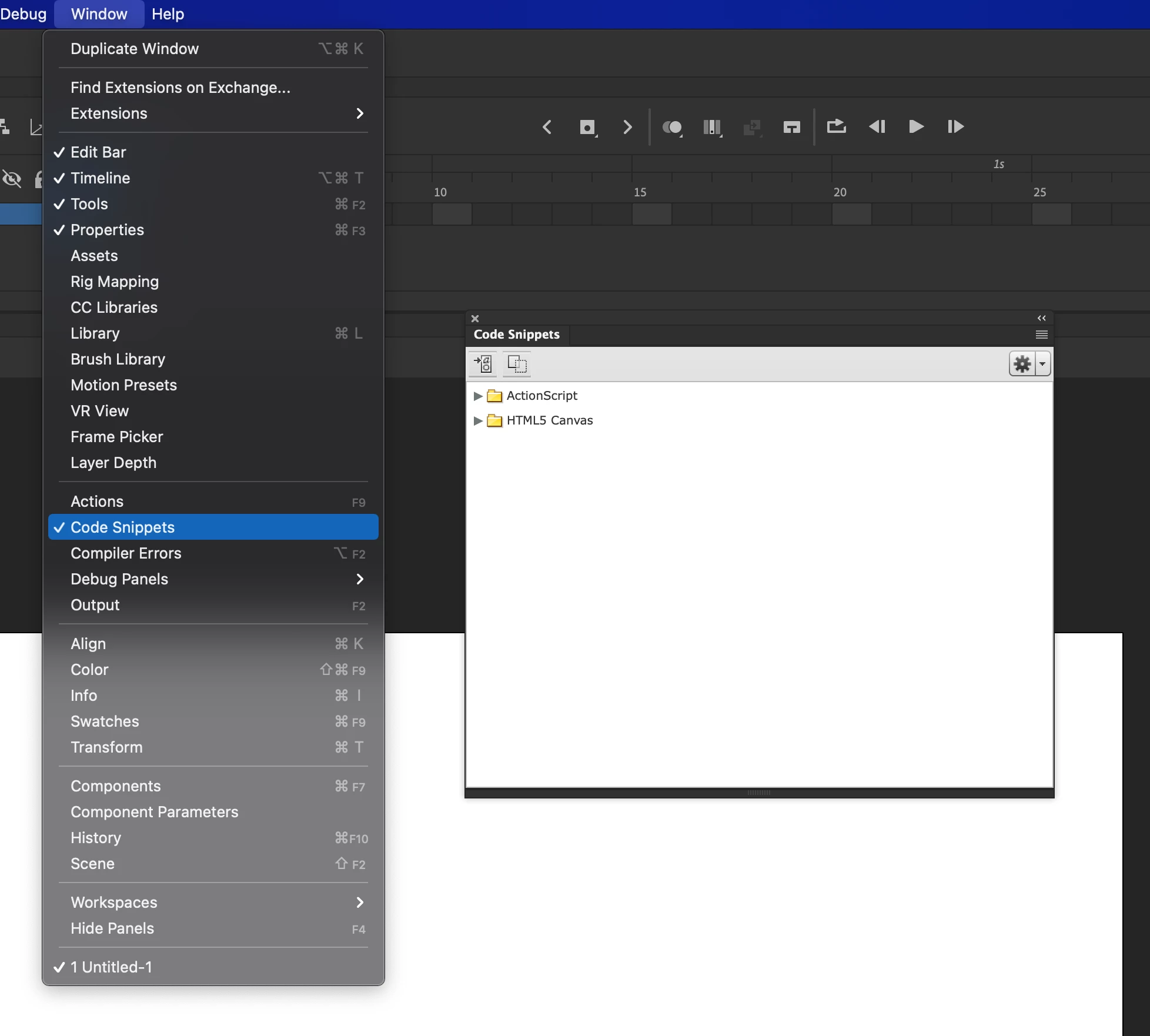

Also, be sure to check out code snippets to help.
