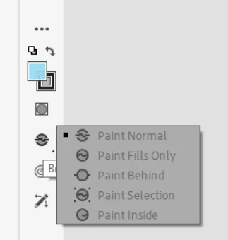

    When you're not painting in object mode maybe it's an idea to check these out (paint behind/inside etc). These options is visible when using the brush tool.
    When your pencil lines are in objectmode its not possible to 'erase' lines (pencil) with fills (brush). When the brush is in object mode it is possible that the fill is in front of the line. Then you have to rearrange the order within a layer (bring to front, bring to back. Or ctrl up/ down). It's also an idea to work in layers (and maybe in the end 'merge layers')
     the square and circle is object mode. It's visible when you select the brush or pencil.
    Good luck.
