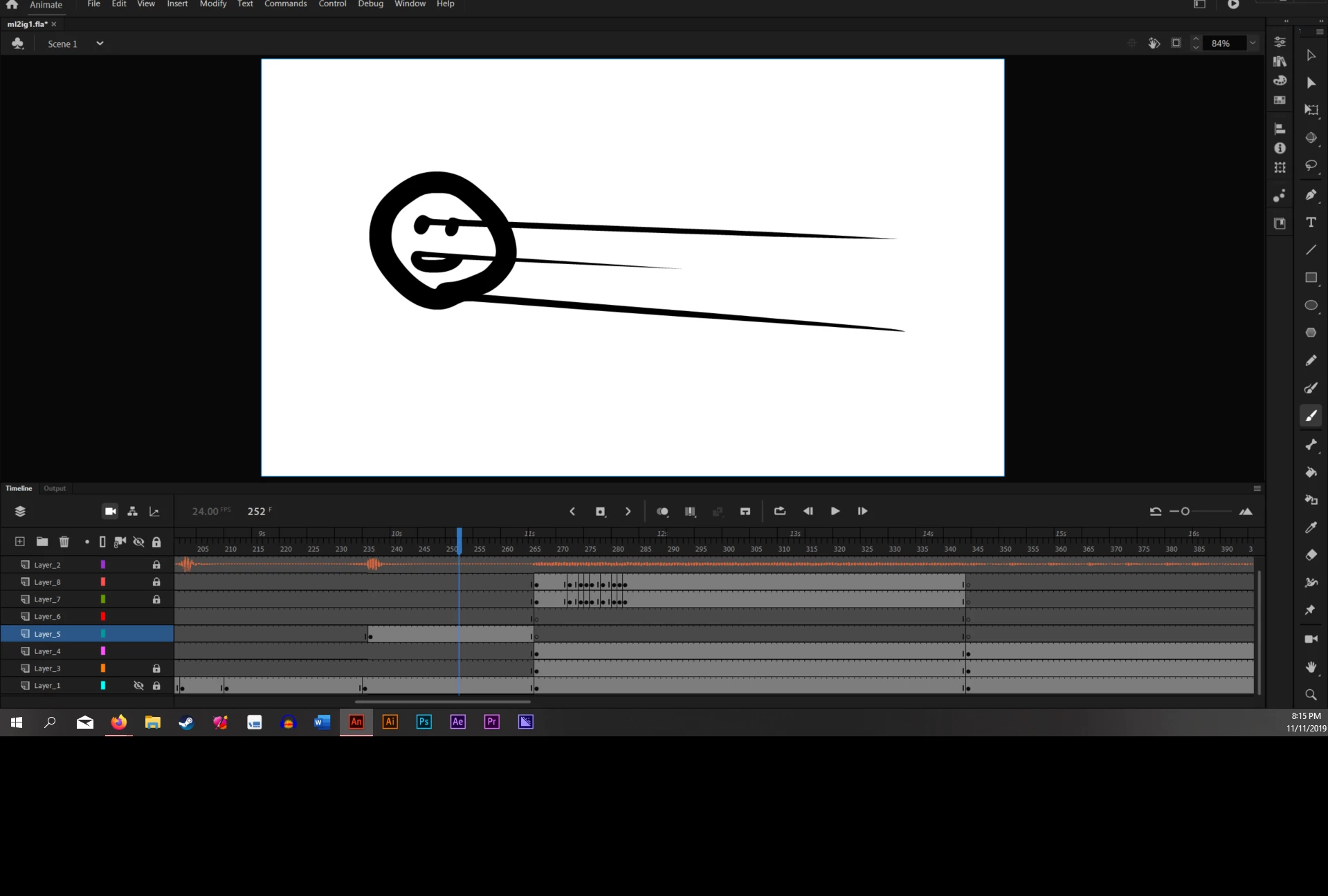

I've been using animate for a little over a year now and have had relatively no issues. However, recently, whenever I use my wacom intuos tablet to use the brush or paint brush tool, tapping the tablet even once causes the tool to make a line that shoots off to the left where the drawn shapes actually appear. The strange thing is, this only happens with animate and on my second monitor. With a different program, this doesn't happen and using animate on my primary monitor works fine too. I've tried updating my tablet's drivers, uninstalling and reinstalling them, turning the computer off and on again, nothing works. Any help would be really appreciated as I don't like using animate on my smaller primary monitor.
