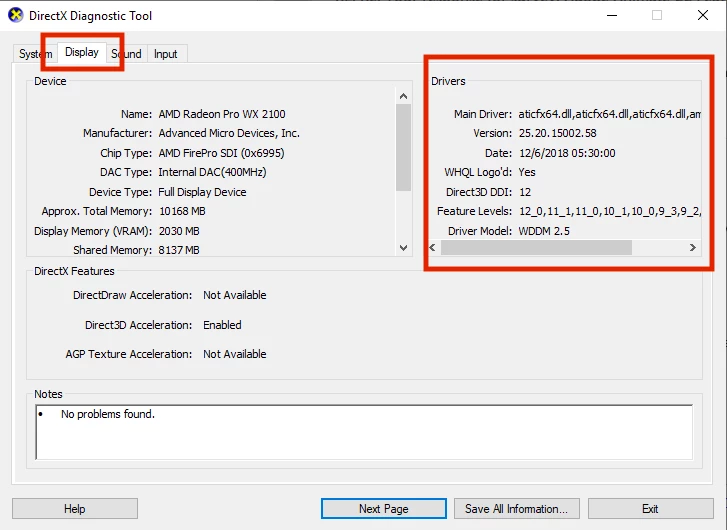

    For Fluid Brush tool, the following hardware specs are required to work best.
    Windows : DirectX 12 compliant GPU (with feature level 12_0 support)
    Windows->Run->"dxdiag" to check the directx specs.
    Please share your Directx specifications with us. Also, try to set "Stabilizer" value in Fluid Brush properties to '0' and share a screen recording of the brush drawing. We will look into the issue of yours. Thanks!

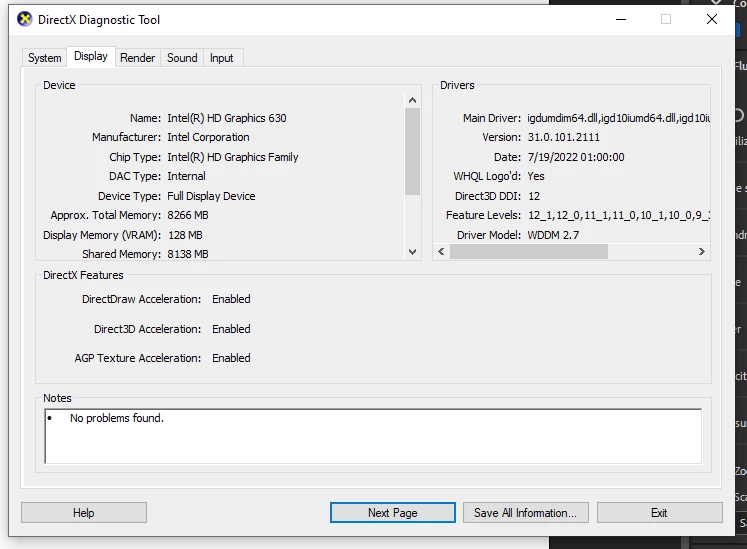

    I may not be the original poster but I am running into the same issue. My graphics driver features level 12_0, and I did set the stabilizer to 0. This delay does not exist in other software (Photoshop and Clip Studio Paint)
    Mario_CR
    Dec 3, 2023 4:56 PM UTC
    Do you have a dedicated graphics card in your PC that is not integrated into the processor like Intel graphics? (Nvidia, AMD, ARK etc). The problem with integrated graphics is that the memory is shared with the cpu.
    If so open Animate using the dedicated GPU and see if you get better results: https://pureinfotech.com/set-gpu-app-windows-10/
