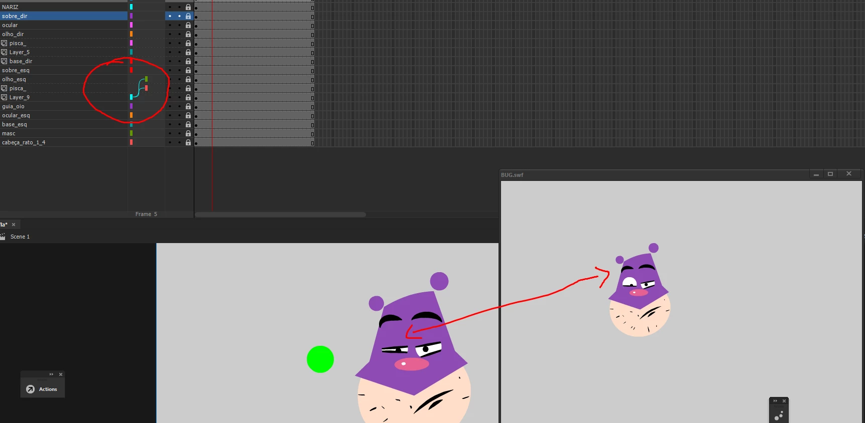

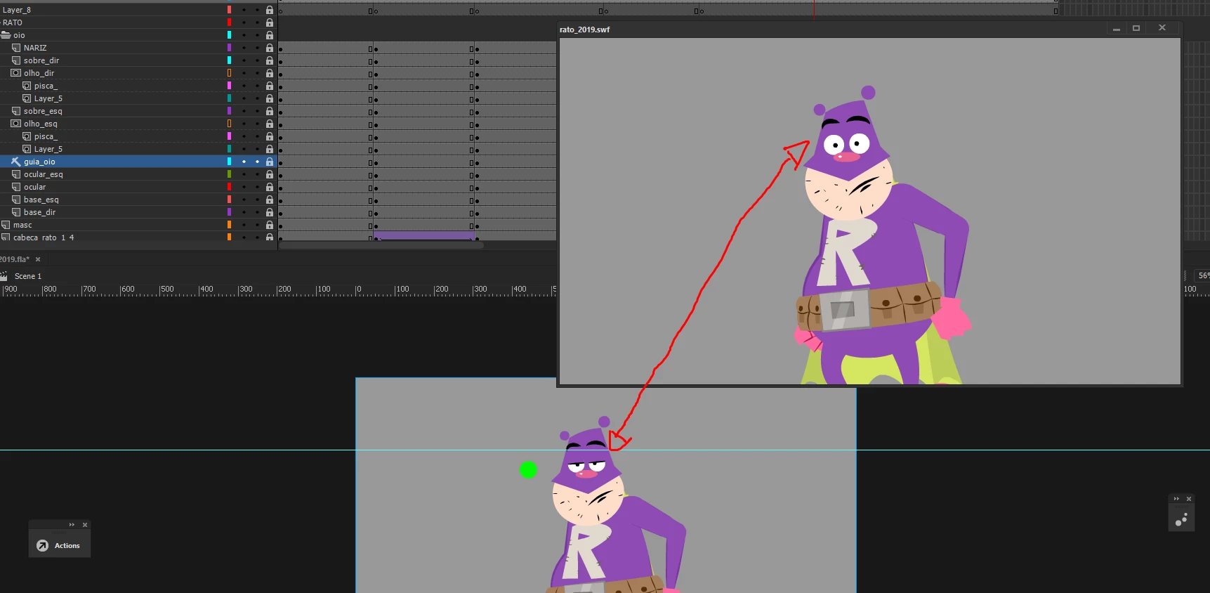

Hello, I noticed that after the last major update I have had some problems with the mask. It bacicamente does not work, as you can see in these print.
Does anyone know what's going on?Update, the problems are in the "parent and child" layers. Is not this form of organization possible?

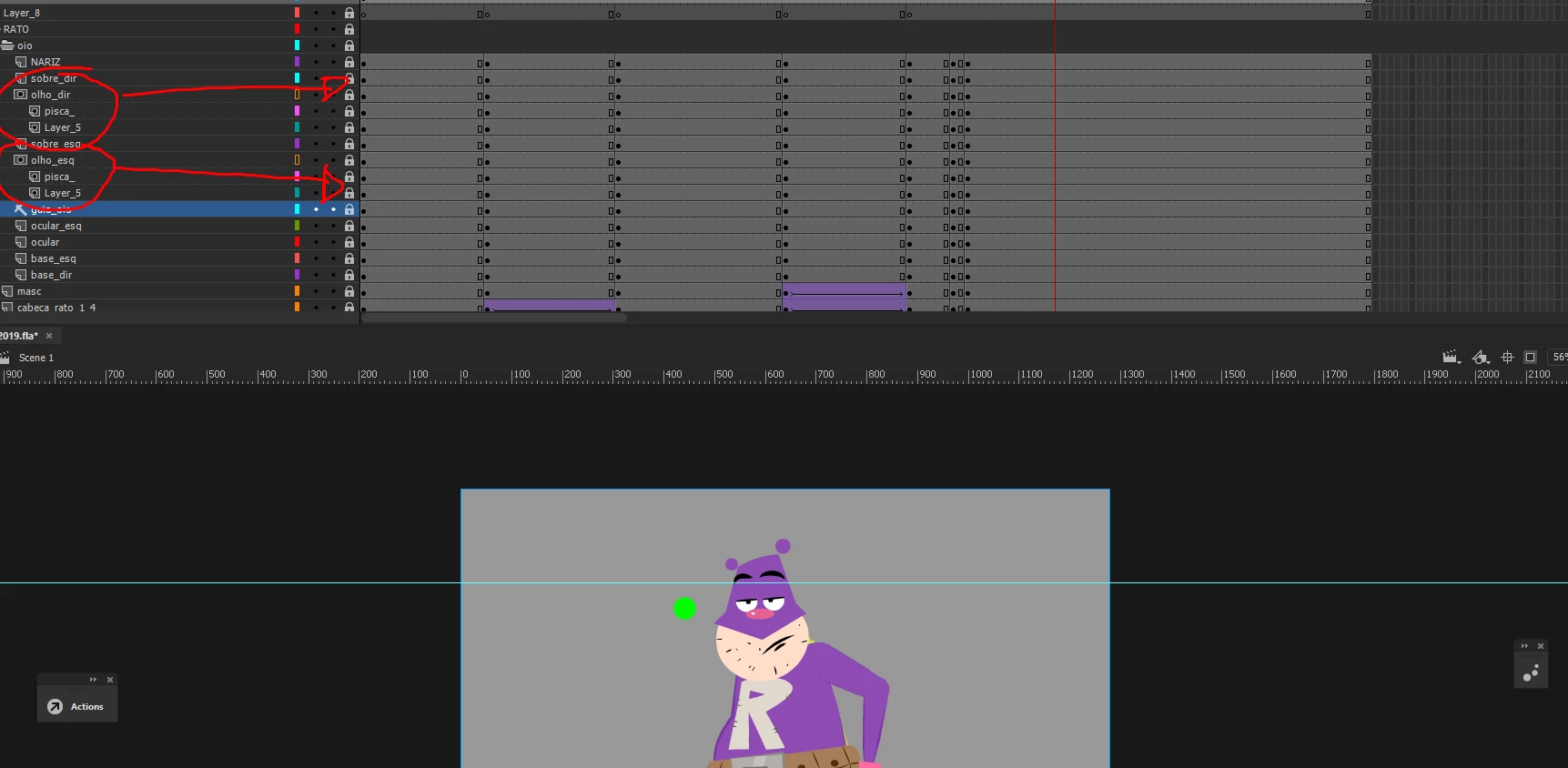

I did some more testing, when the mask layer is connected to any other layer, the mask stops working. It only works when it is connected to what it is masking.
This unfortunately limits some actions that could help you do the rigging.
