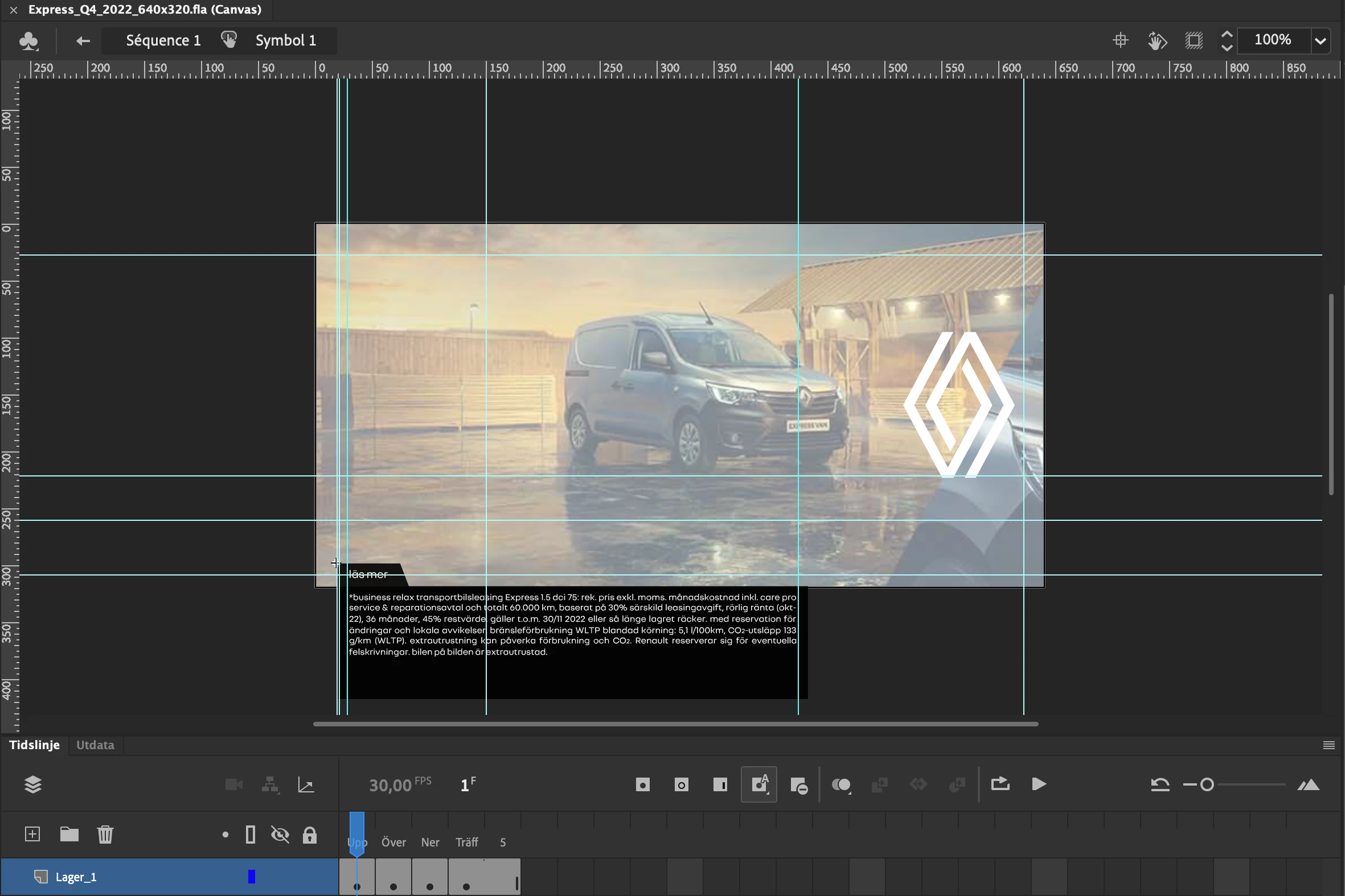

Hi.
Wondering how to get this button to work when I export it to HTML-5 using actionscript? The area for the button also seems to be too large. How to get the technical to be good and that mousover is only used on the "läs mer" surface? Can't get the action script to play correctly or at all.
/M.

    Jan 3, 2023 1:49 PM UTC
    Hi.
    If your text field is inside of a button, draw a shape (or shapes) in the Hit frame for the areas you want the mouse over to happen.
    JC
    Jan 5, 2023 10:02 AM UTC
    Thanx. I´m not doing well with this.
    Can´t make the shape and I don´t get the code right or any code, I have just told the layer if up, over, down and hit.
    Probably completely wrong but I'm not giving up, yet...
    I´m a beginner with Animate.
    /M.

    Jan 5, 2023 11:18 AM UTC
    Here is a sample:
    https://bit.ly/3X8vEMU
    It turns out that in this case a custom hit area isn't needed.
    Also, you can remove the animations if you want and just leave the static visuals.
    I hope it helps.
    JC
