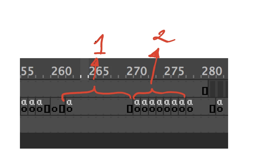

This may be a stupid question but I am not being able to solve it by myself ...
I have been animating gotoandstop buttons in AS3. Sometimes I can make the button work along several frames and other times it doesn't work and I have to use one button in each frame for the same function... can't figure the difference or what am I getting wrong ...
Any help here?
Thanks

    Hi again, sorry for my bad english ... and bad explanations about my problem...
    "I have several buttons" - I am trying to use the same button symbols in several frames, with different instance names.
                                                 That's what I am doing when the same button that appears in diferent frames doesn't work on the                                               second and next frames
    "I am able to use the same button and code in 3 or 4 different frames" -
    This is the code:
    btclosememoria.addEventListener(MouseEvent.CLICK, fl_ClickToGoToAndStopAtFrame_31);
    function fl_ClickToGoToAndStopAtFrame_31(event:MouseEvent):void
    gotoAndStop(242);
    But in some places it works from the frame where I code through the next frames (1) where the button appears and in other places (2) I have to put 5 or 6 diferent buttons with the same image and code to do exactly the same function.
    It is probably something very basic that I am not getting.
    Thanks for trying to help...

    Hi Klaus
    It is the same project but the question is different and it happens in different projects.
    Thank you for the answer for the previous one, it worked perfectly
    Let's see if I can explain better.
    In the same timeline, I have several buttons with the AS3 go to frame and stop, in some places of the timeline I am able to use the same button and code in 3 or 4 different frames and in some other places I have to create different buttons for each frame even the action I want to use is exactly the same and I want it to go to the same place with the same button. I can't understand what changes to change the button behaviour.
    I would share the project but it is a general doubt I have...
    Thank you again
    Ana
    Does that mean you have several button symbols in your library or you use the same button symbol in several frames?
    Can you please past this code in your next reply?
    "in some other places I have to create different buttons"
    Again, what precisely does that mean, different button symbols from your library placed into those problematic frames or the same button symbol with different instance names?
    further questions:
    • this gotoAndStop() code, did you place that into each frame where a button is or did you place that just once into your timeline?
    • You will be using keyframes, is/are your button(s) instance-named in each of those keyframes. The same name as you use in your scripts like myButton in mybutton.addEventListener(MouseEvent.CLICK, myClickHandler); ?
    You know, your explanation is still somewhat unclear and this is an indication that this is also the cause of your problem.
    Klaus
