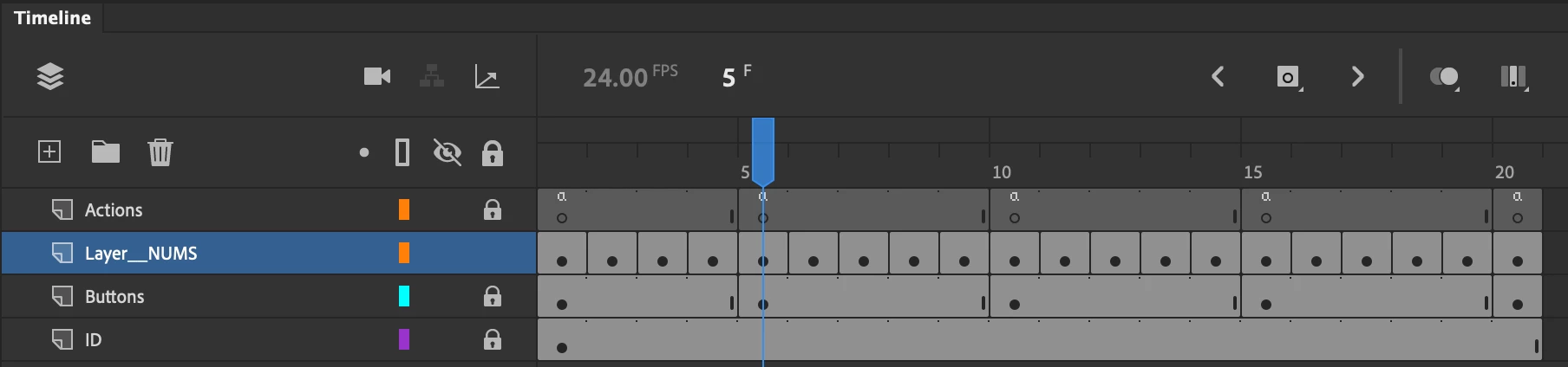

I am having an issue with navigation in Adobe Animate CC 2020.  I have not used Animate with any coding since the early Flash days and I have a project that requires as simple navigation of a Back and Foward Buttons that will allow to move through the timeline.  The problem I am having is everything works great the first time through each button either moves foward to the correct frame and stops on the next frame with the buttons or goes backwards appropriately.  Where the problem occurs is once you you have moved foward or backwards with all of the buttons at least once, all of the back buttons no longer work properly and don't stop on the intended frame and instead just loop back to the frame the button is on.  Is there something I am doing wrong?  Below is the layer set up code for each frame.
Actions Layer - Has all of the actions for the buttons and a this.stop() on every 5 frames so the buttons only advance or go back to the next or previous instance.
Button Layer - Every 5 frames is a new keyframe with the new button instance
ID Layer - just the text of the buttons to show forward or backwards.  It is consitant through out the 20 frame test

    You know addEventListener() in Animate is cumulative, right?
    kglad
    March 31, 2020
    the code on your initial frame is in frame zero.  it should work properly.
    the code on your 2nd frame (with code) is in frame 5, 3rd is in frame 10, 4th is in frame 15 etc. and these all have a problem and won't work the way you expect.
    you may need to reread the above a few times to understand that problem, but code on frame 5 (the 6th frame in your timeline) saying to go to frame 5 isn't what you want.  you probably want it to go to frame 6 (the 7th frame in your timeline).
