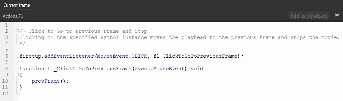

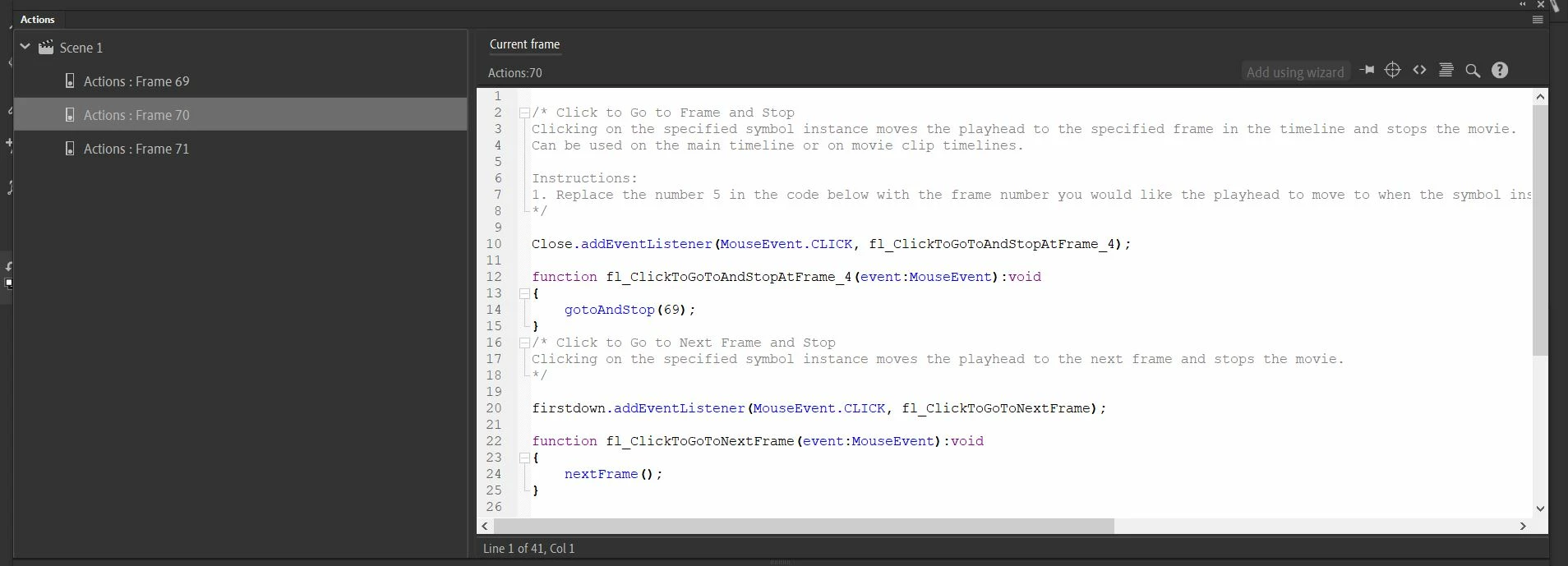

    Thanks for getting back to me. Ok, how can I do that? This is my 'next frame' button which is on frames 70-72 (I also have a close button to transport to frame 69 and I'm not sure if that's relevant):
    And my 'previous frame' button which is on frames 71-73:
    So do I make any adjustments to these or do I do something else?
