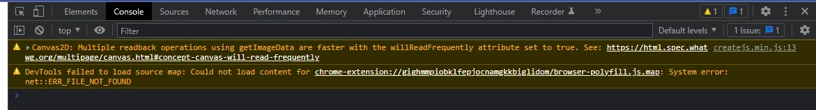

This was the console warnings -

    i'm assuming you're not seeing any warnings/errors after startup.
    MowyTAuthor
    Apr 15, 2023 9:15 PM UTC
    where would that be though because all have an instance name?  and yes I dont see any errors but I still see the warnings they stay the same, they dont seem to be the issue i think.
