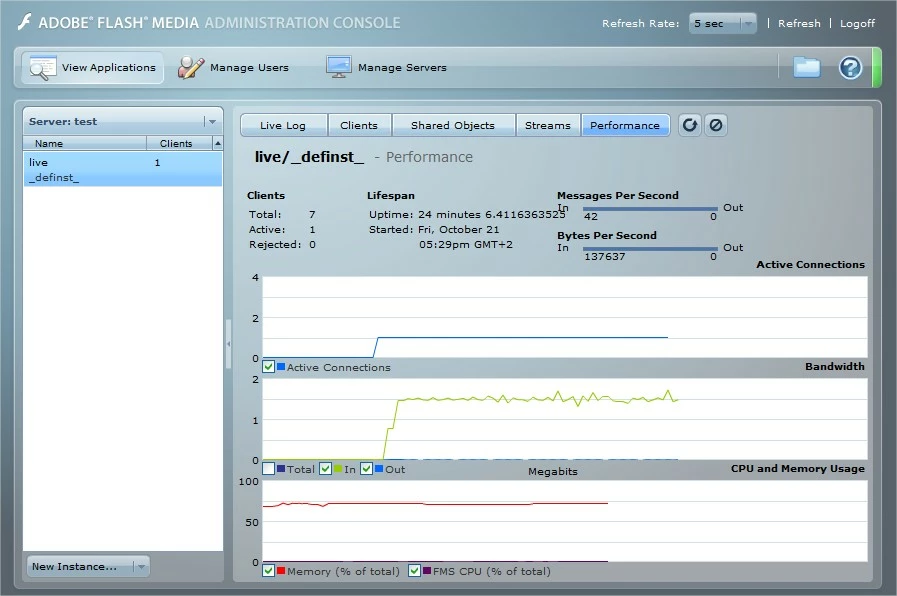

I am using the new Flash Player 11 ability to encode the webcam video with H264 codec and send it via RTMP to a Flash Media Server. It works, but the bitrate of the video stream is not constant. Therefore the resulting stream is stuttering when playing back.
I tested it in two ways:
A) Encoding and sending the webcam video to FMS via FMLE -> very fluent playback
B) Encoding and sending the webcam video to FMS via Flash Player 11 (all setting for codec etc. are the same) -> playback is stuttering
As you can see in the screenshots below, the incoming bandwidth at FMS varies a lot. When using FMLE the incoming bitrate at the FMS is very constant:
In contrast: when using FP11, the bitrate jumps between 1000 and 6000 kbps during the whole stream:
That is definitely the reason why it "stutters" when using Flash Player 11. But I have no idea what I am doing wrong.

Correct answer Jozsef_V
In Flash Player 11, we used variable bit rate (VBR) mode for rate control. This has been changed to constant bit rate (CBR) in the next version, so you should expect much better results.
You should also use RTMFP instead of RTMP for the uplink. That should significantly improve your video smoothness.
Jozsef

Jozsef_VCorrect answer
October 25, 2011
Jozsef

Hi Jozsef,
thanks for your answer. In which version and on which date will the CBR be implemented? Flash Player 12? Or a minor release of FP11?
And until then I have no chance to have a constant bitrate? The bitrate I am passing to Camera.setQuality will just be ignored? Or is there any workaround?
Thanks and I will test using RTMFP instead of RTMP, but the CBR is the most important thing for us.

October 26, 2011
Next version, definitely before 12. Private prelease probably already available.
