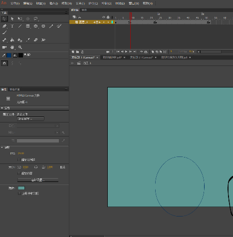

I am doing a frame by frame hand drawn animation and I want to save myself as much time as possible. I am trying to fill color on my drawings but they aren't all contained inside the stage border. For example, I have a closeup of a character and the camera is showing their heads and shoulders and the lines exit the stage at the bottom. I can use the paint bucket to fill in the character's face, but it won't do anything to the character's arms. I thought I was being clever when I created a layer with a rectangle drawn around the stage to close the gaps, but then the paint bucket fills the entire stage. Anyone know how to close offscreen edges?

My current workaround is extending the lines a little bit below the stage and then just drawing a straight line across all of them at the bottom so they are closed off for filling.

Oh yeah, I understand what you are saying. I did have the color layer under the line layer, but since the lines run off the edge of the stage, the program doesn't see the edge of the stage as the edge of the shape it is trying to fill, if that makes sense.
