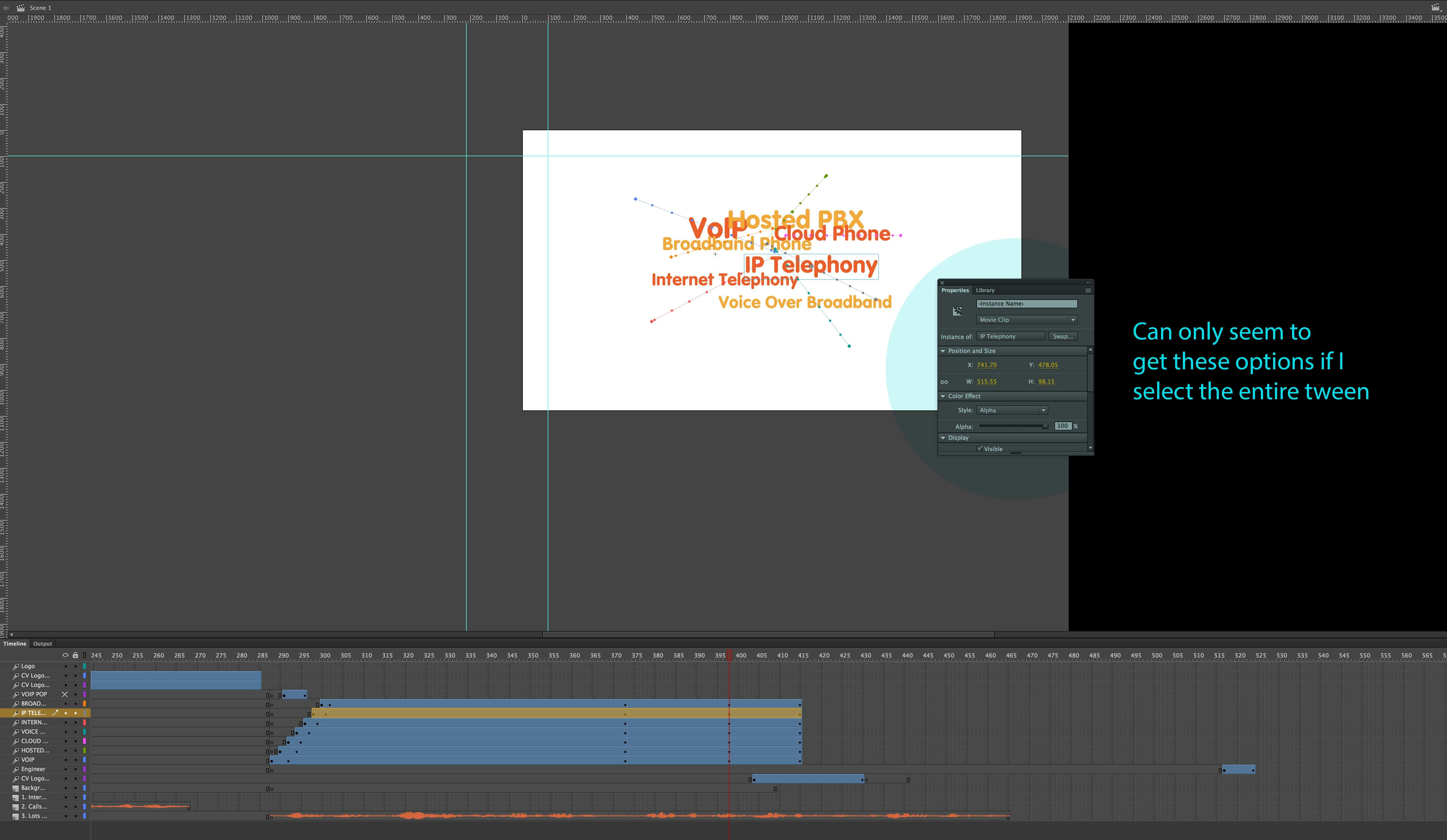

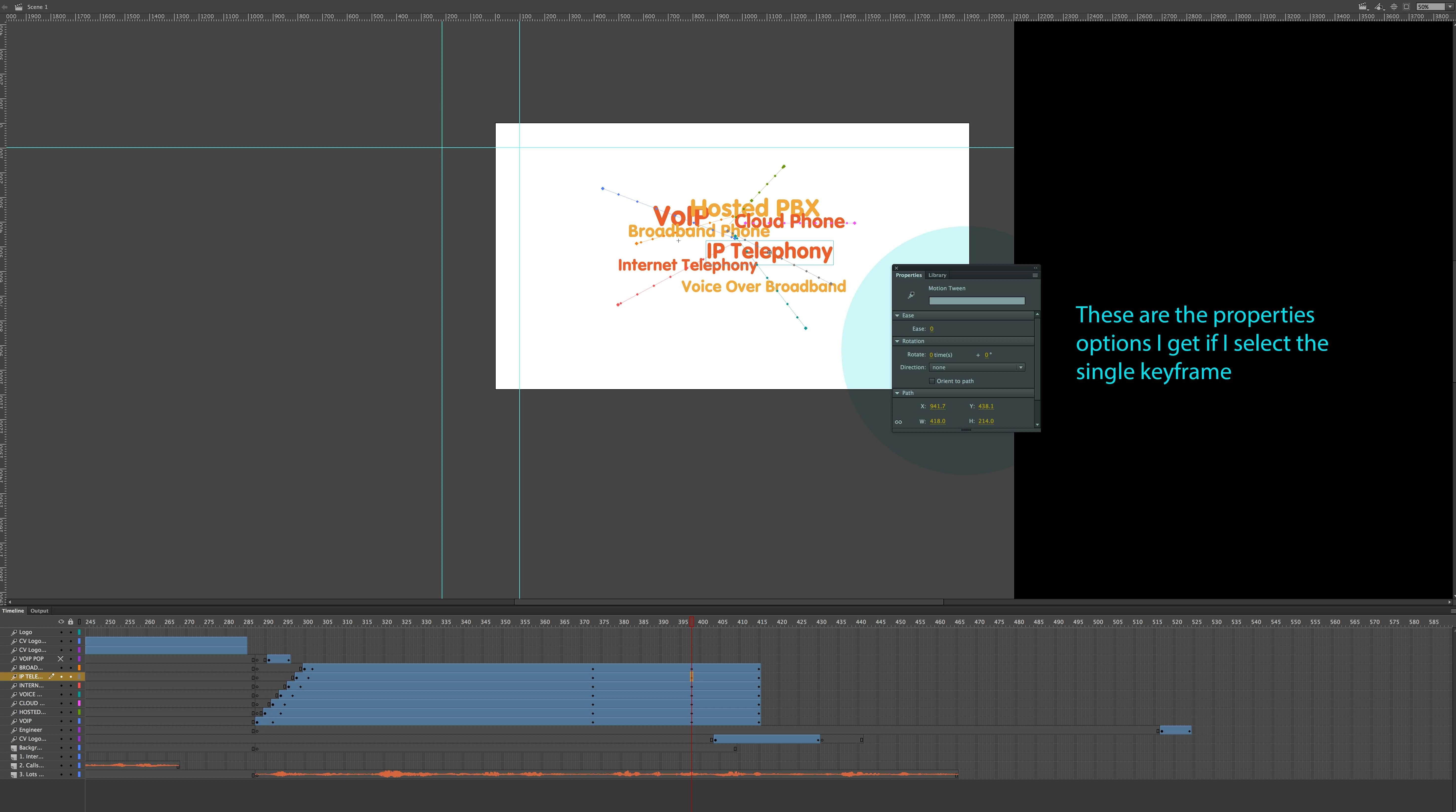

    I'm attaching screenshots for a better description.
    I have to click on the symbol itself to get the correct properties options up, but clicking on the symbol selects the entire tween and applies it from the start.
    I want the transparency to kick in at the selected keyframe, not the start of the tween.

    Although the span is all highlighted it should only be applying the change to the current frame. You should see a keyframe dot appear after you've made the change.

    Thanks - That doesn't seem to be happening Colin... do my screenshots illustrate it any better?
    Colin Holgate
    March 31, 2017
    What you describe is the correct behavior. You would only want to see the motion tween info in Properties if you intend to move the entire tween to somewhere else on the stage, then you would click in the timeline. If you only want to create a new keyframe for a one property you would scrub to the right frame, then click on the instance on the stage. The whole tween does highlight in the timeline, but changes you make in Properties only affect the frame you are in at the time.
