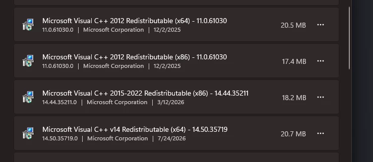

    do you have these visual c++ versioons installed
    Aug 15, 2026 11:11 PM UTC
    I have 2015-2022 x64 and x85, not sure what it means though haha I am not good at tech stuff
    kglad
    Aug 16, 2026 1:17 PM UTC
    install the others.
