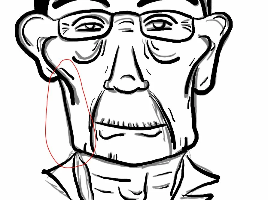

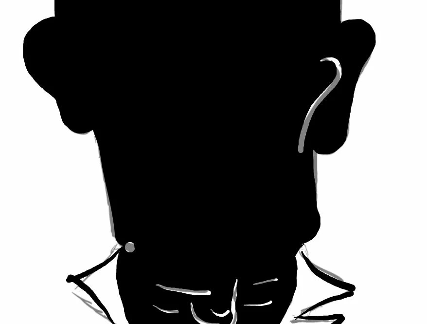

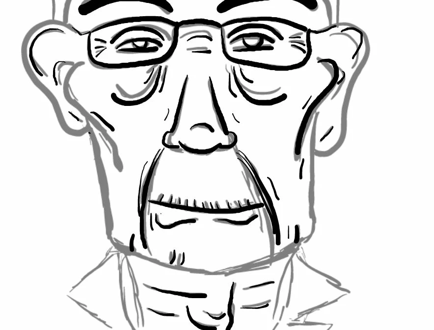

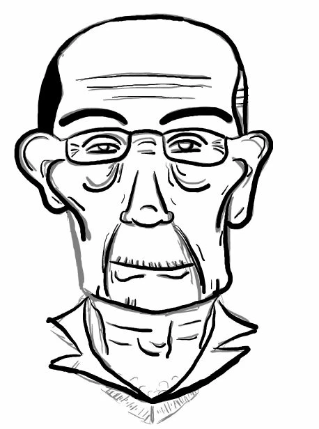

I want to simply draw an old man's face with the fluid brush in black ink (picture 1) according to a drawing I previously made in Illustrator. The problem is: When I finish the man's face (picture 2), it suddenly gets filled completely in black (picture 3). If I try to undo it, all the strokes get deleted (picture 4) and so my whole work is basically lost. I've tried to set the brush filling to transparent, but it automatically changes back to black colour. If you have any idea how to fix this issue, I would be very very grateful for everything that helps. Thanks!

My guess is that the vector art gets too many points and 'too complicated' and because of that you get some kind of vector shape corruption.
My suggestion is to turn Object Drawing ON. This will keep each brush stroke as a separate object and such potentially problematic stroke interactions will not happen.
Later when you finish your drawing, you may want to Break Apart everything, if you need to fill with colour using the Paint Bucket. This may lead to similar problems, but at least you will have your file saved and will be able to break apart in sections to identify the problem area and try to clean some unnecessary points to avoid shape corruption.
As an alternative, you can color your image on a separate layer and keep the outlines as individual brush strokes.
