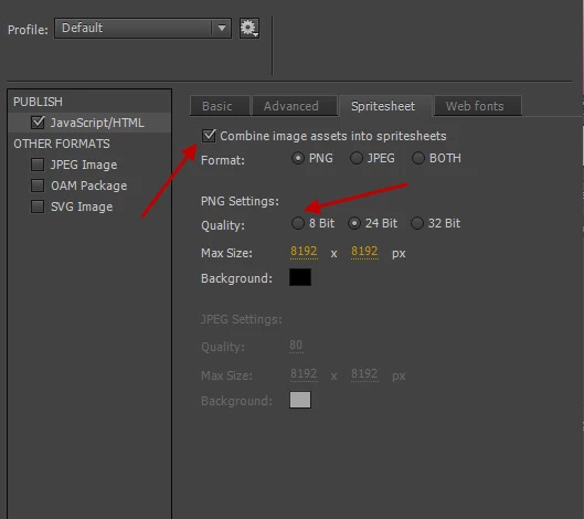

avid_body16B8
March 29, 2019
Somehow  I missed the word conversion in this post. Glad Klaus was here to answer!!!
avid_body16B8
March 29, 2019
I wonder if you could tweak the publish some more. If you do not need high res you can set the images to be saved at a lower resolution. After you choose the resolution click OK. then reopen and click advanced again and decide if you want to combine in a spreadsheet or not.
