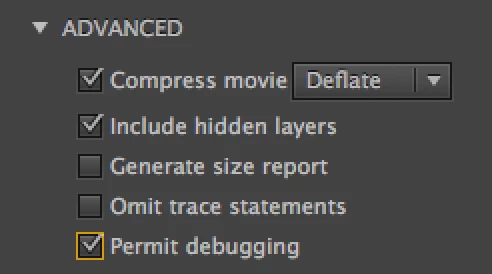

One other tip, if you turn on Permit Debugging in the Publish Settings, the error will then tell you which frame and which line has the problem:
April 12, 2018
Thank you  Colin that’s a good tip as well thank you so much guys for your help .
