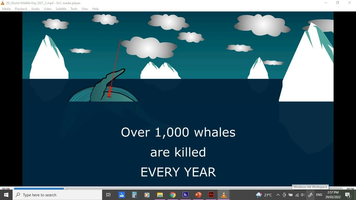

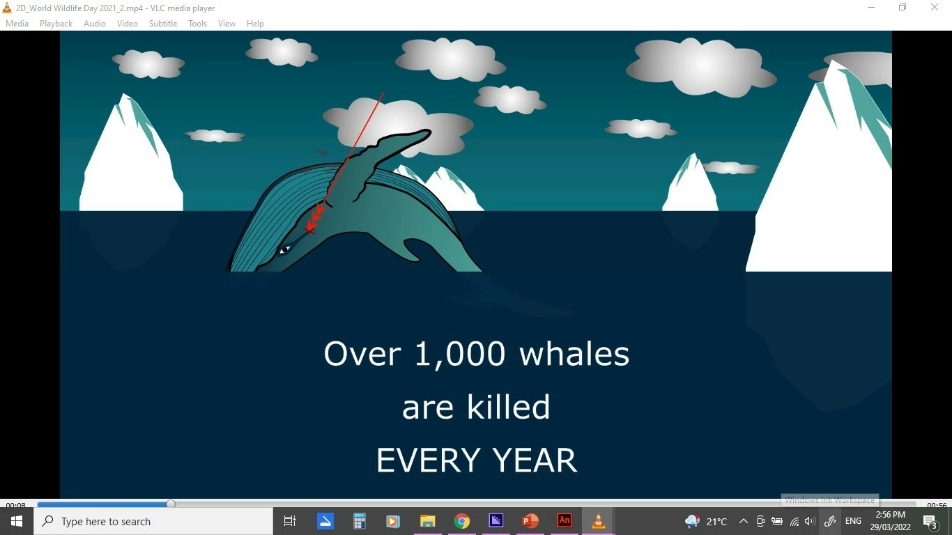

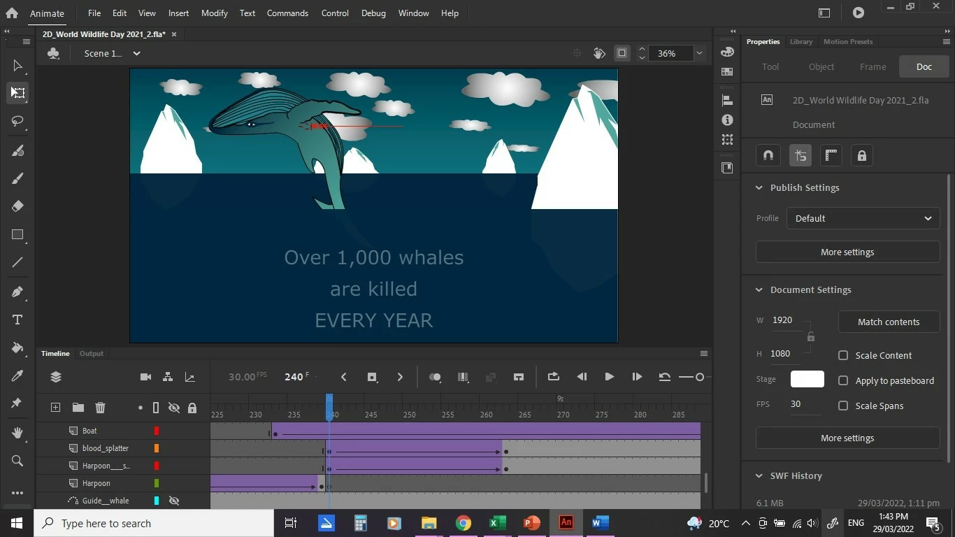

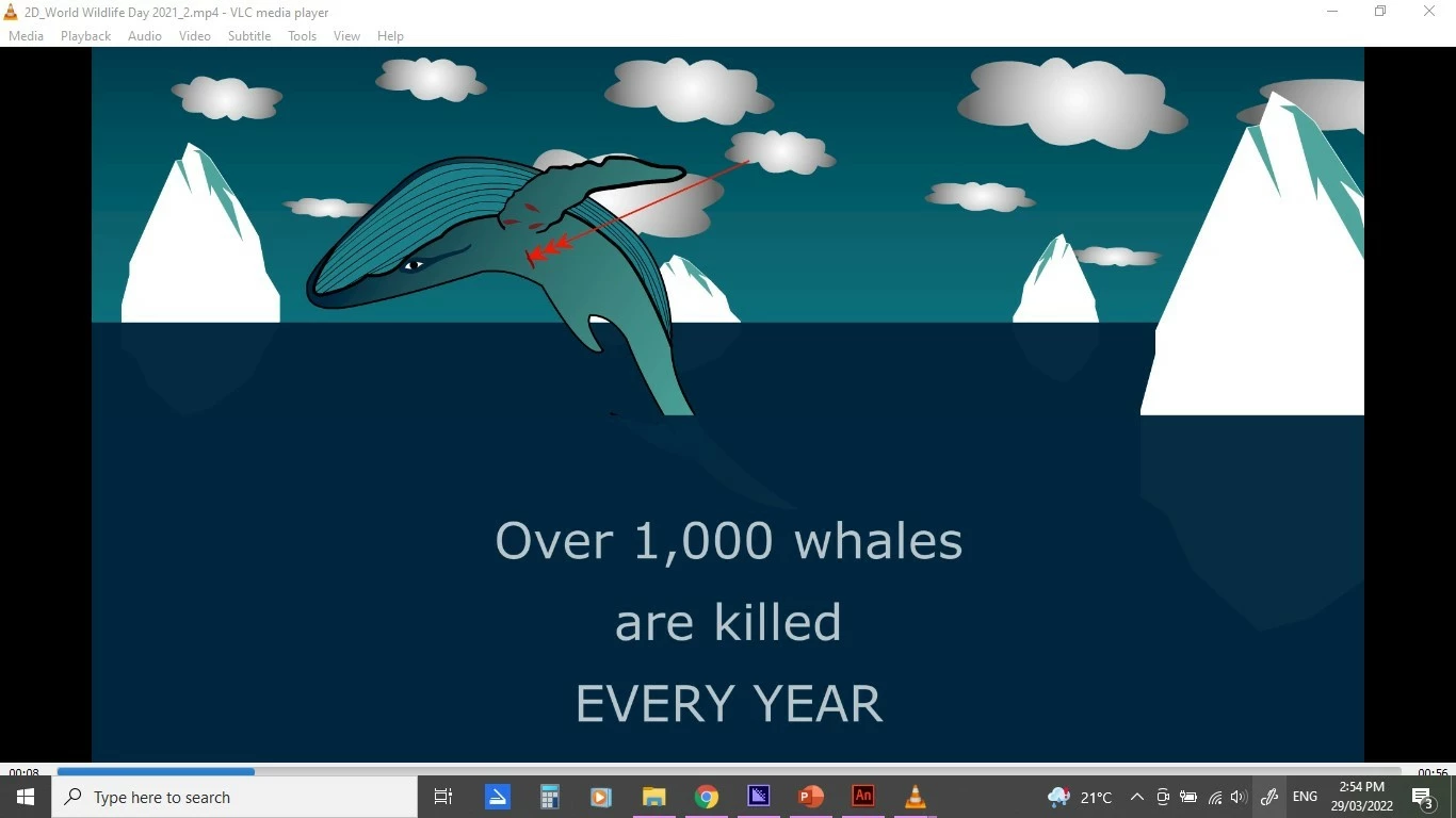

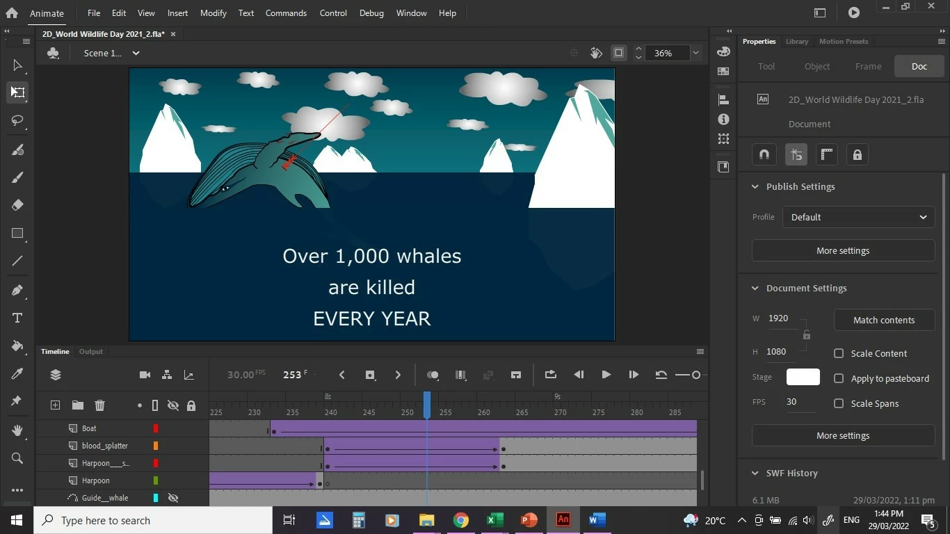

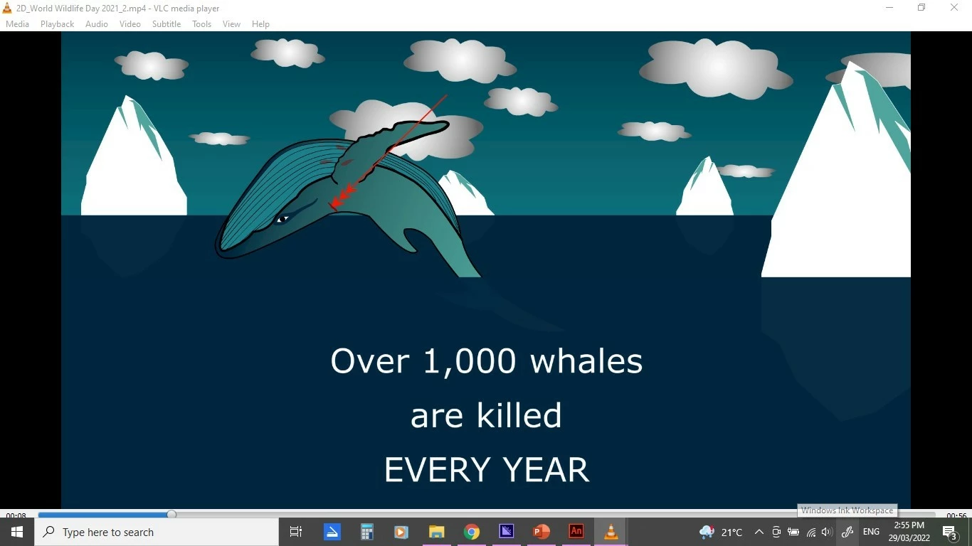

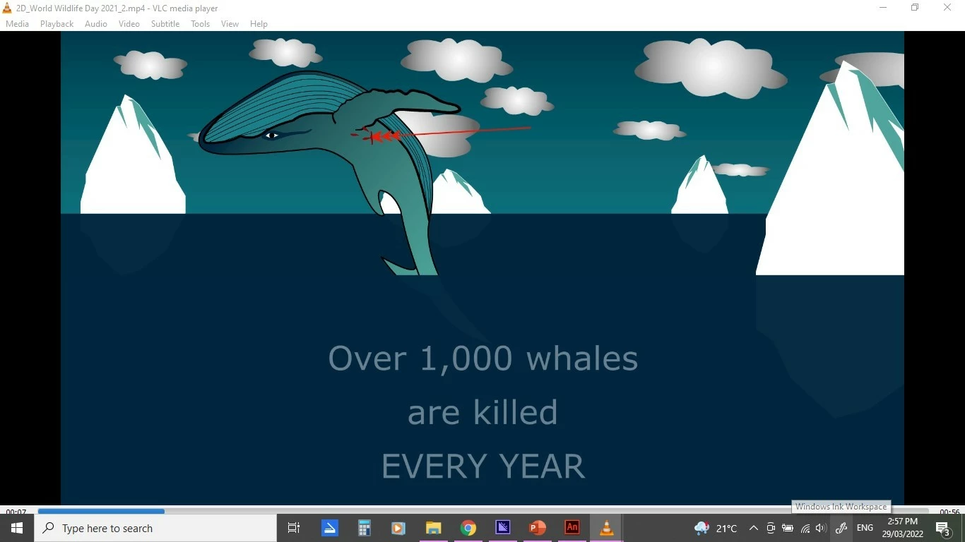

    The best I can provide is screen shots:
    The problem is with the harpoon. In edit mode it works perfectly, staying in the correct position (lodged into the whale). See below:
    However, when I test and/or export the movie, the harpoon jumps from its position. It places correctly at the first and last positions, but in between it jumps way out of line as shown here:

    Looks like a fun project. Also looks like you are using a guide, but then you have other layers of the Harpoon without any link to the guide. Could this be the issue? Make sure the harpoon is flying on the guide the entire time to keep the arrow on the path.
    Hope that helps.
    mark
