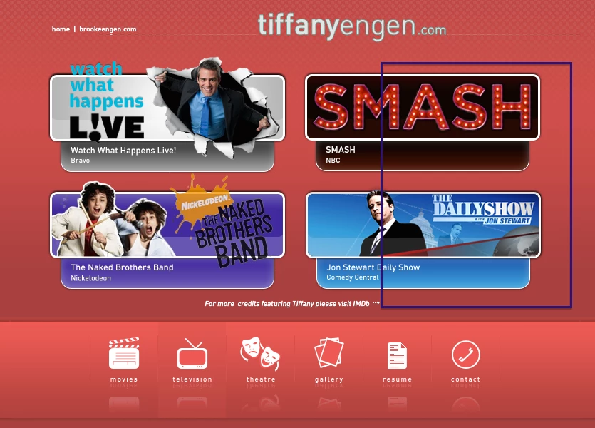

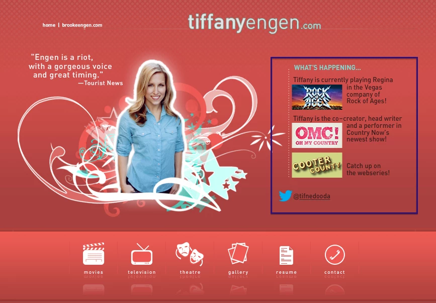

I'm attaching two screenshots...one of the HOME scene and one of the TELEVISION scene.
On the HOME scene, there are four buttons on the right side (Rock of Ages, OMC, Cooter County and Twitter...outlined in purple). If you click on TELEVISION in the navigation, in the area where those four buttons previously were on the HOME page, there are rollovers still active. (In the area outlined in purple, the pointer turns to a hand as if there are links there, and if you click in that area it'll take you to one of the links from the buttons before.)
Likewise, there's only one button on the TELEVISION page (the link to IMDb at the bottom). If you go to another scene, say THEATRE, the area where the link was for IMDb still has a rollover area there.
Each scene always has the rollover areas for the current scene but also rollover areas from only the immediately previous scene.

I understand now, thanx.  For those rollovers/links to still be active means they are still present.  That will mean they are either alpha-ed out to 0 so that they are no longer visible (but fully interactive still), or they are hiding behind the new content that took over the area.
You'll need to examine the fla file to see how the content transitions are managed to see why the old content doesn't go away until a move later.
