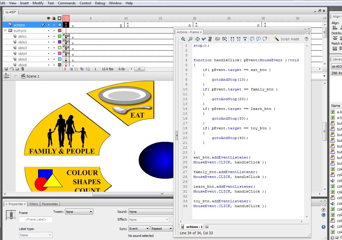

I have several buttons in frame one and used the following actionscript which works fine
CODE:
stop();
function handleClick( pEvent:MouseEvent ):void
          if( pEvent.target == eat_btn )
                    gotoAndStop(10);
          if( pEvent.target == family_btn )
                    gotoAndStop(20);
          if( pEvent.target == learn_btn )
                    gotoAndStop(30);
          if( pEvent.target == toy_btn )
                    gotoAndStop(40);
eat_btn.addEventListener(
MouseEvent.CLICK, handleClick );
family_btn.addEventListener(
learn_btn.addEventListener(
toy_btn.addEventListener(

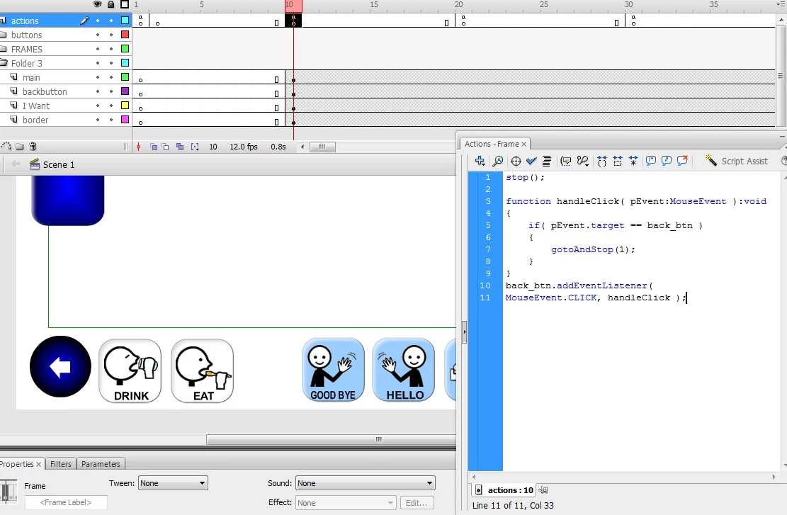

untill I want to use the same coding for my back_btn in frame 10 through 80, my whole application goes wacko!
CODE FOR BACK BUTTON USED IN FRAME 10
stop();
          if( pEvent.target == back_btn )
                    gotoAndStop(1);
back_btn.addEventListener(

You defined function handleClick() twice. Once in frame1 and once in frame10. Try naming them handleClick1() and handleClick10(). That should do it.

function handleClick10( pEvent:MouseEvent ):void
                    gotoAndStop(1);
back_btn.addEventListener(MouseEvent.CLICK, handleClick10 );
I changed both the upper and lower one as follows, and for the other frames to "..Click30..40..50..etc" and it worked like a charm
