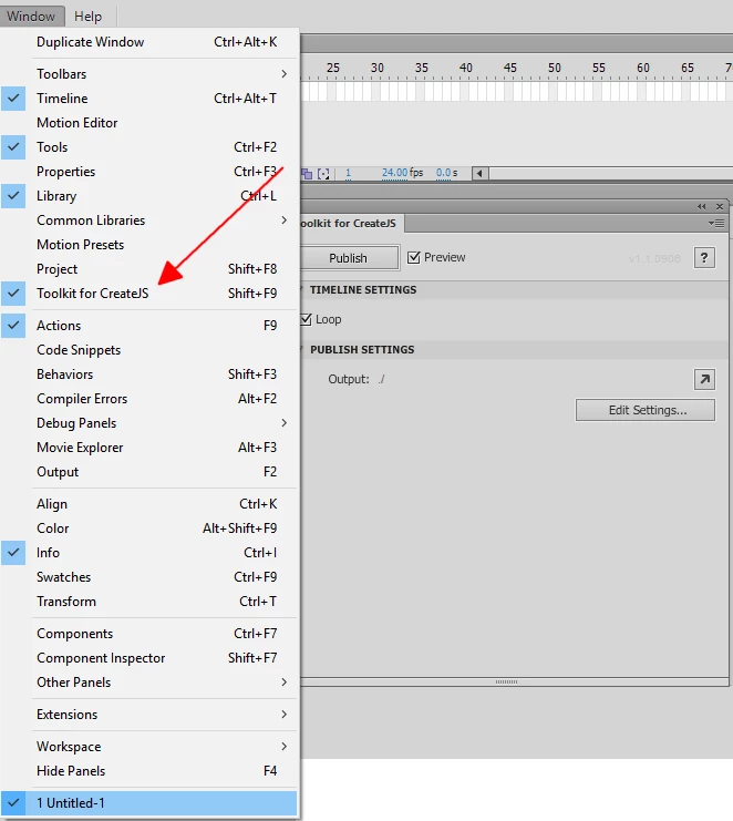

    in cs6, to view the toolkit panel, click window>toolkit for createjs
    it's commands>publish for createjs to publish

    Thanks for the reply.  Yes, you are right, I did find it there (...the plugin instructions show it as being within the Other Panels menu).
    Okay, but I'm still not understanding how you do an HTML5 export, which was the whole point of me trying to install that toolkit (which appears to already be installed).
    Does this preloaded toolkit give you the ability to do HTML5 exports, or is this something unique to the Toolkit For CreateJS that I was trying to install?

    again, use it's commands>publish for createjs, to publish or create an html5 app.  (or use the publish button on the toolkit panel.)
